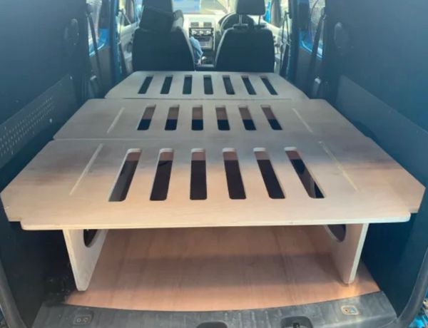

Hey up! Here's a few links for using a mid sized van as a part time camper and a working van.... (based on a combi layout with no bulkhead).
For your bed idea, I really (like, REALLY) recommend this guy. His build designs are phenomenal and really well thought out. And if they're not in your budget, you could use his design layout and make it yourself.....
Another idea for a bed for your youngest can be a cabin bunk. We used one before we did the pop top and it worked a treat. So simple, so effective!
