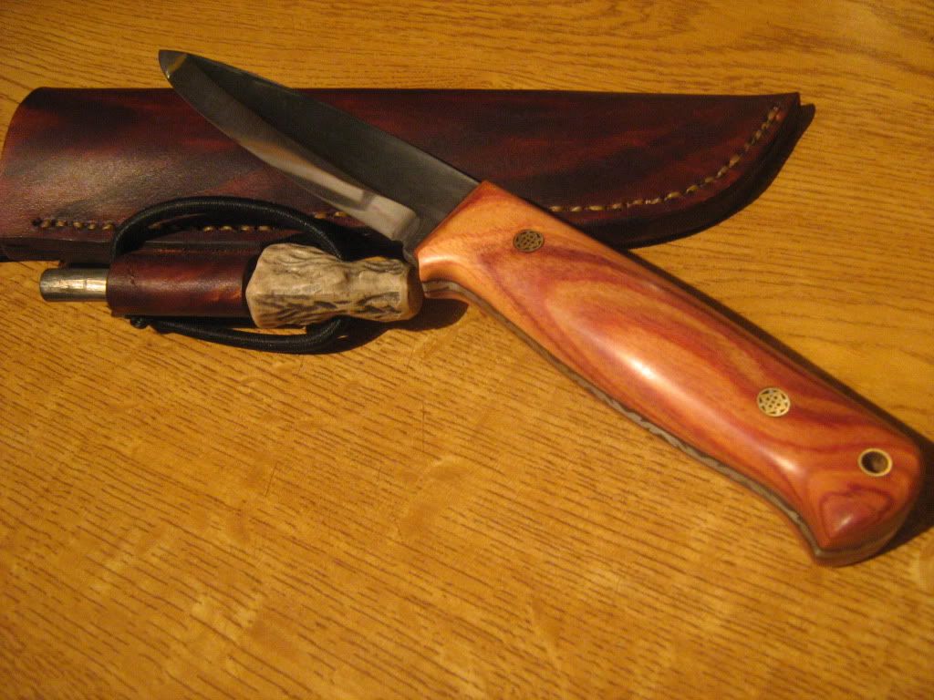

Well, here she is!
Enzo knives from Dennis at Brisa need no introduction from l'il 'ol me, but I've not seen many in Tulipwood.
Thanks to all on here for the previous advice. I pulled the trigger and got the tulip kit and I love it.
Tulipwood is hard and great to work with. It doesn't take much to polish it, icarved the n fact I only had to go as far as 240 grit, albeit with a wire wool polish. I filed the excess off and carved the vulcanised fibre flush with the 01, just because it seemed easier.
I coated with CCL gunstock conditioner oil and finished it with carnauba wax. It takes a shine nicely. I could have spent a lot of time making this a showroom knife but every time I do this it stops being a user and becomes a "shelf" knife, and I don't need another one of them! This Enzo had to be a user and it is. It is now in the back of my pack ready for use.
Tulipwood does have a problem though. It's very shiney and hard to photograph! I might try some indoor pix soon but here's what happened when I took her to the beach today...
[/IMG]
[/IMG]
[/IMG]
[/IMG]
[/IMG]
[/IMG]
[/IMG]
It's not curly birch for once, but it's different enough to love it. A real keeper!

Looks lush, that's the first Enzo I've seen in Tulipwood! Might have to get some for myself, it does look nice when finished. Well done and good choice there!
