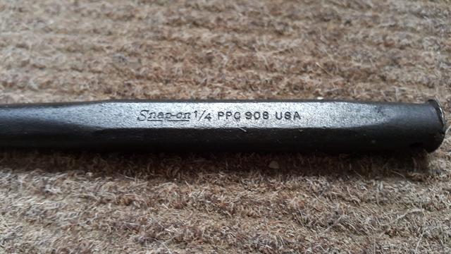

I was working at an empty property this week that's being cleared out for renovation. There were a couple of rusty tools by the bins that the owner said I could take. I only really wanted the trowel but took the other thing because it looked useful. I thought it was a pin for securing something but didn't give it much of a look.
The pin thing turned out to be a snap-on punch and has cleaned up well so I'm pleased with that. :biggrin:

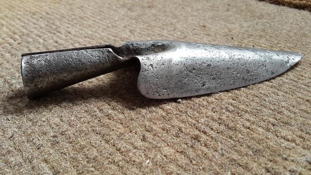

I tried wire brushing the trowel then a quick overnight in vinegar and it's coming up nicely but has some deep pitting from the rust. The metal is quite thick though and it's got a really solid handle fitting so if I can turn it into a user I'll be very happy.
Out of the acid and cleaned up with the wire wheel.
Then a bit of work on the sander to remove the light pitting. I'm taking it slowly so I don't heat the metal too much.
The inside of the blade looks pretty bad though, nothing that would stop it being usable I guess but I'm not sure how far to take the restoration. Does anyone have any tips for dealing with this that will make a better finished result?

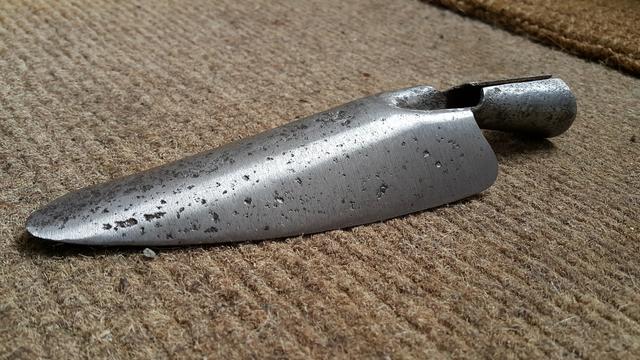

Fair enough. I don't want to affect the strength but I'm hoping to make it easy to clean at least. I've managed to remove the old handle intact but it feels as light as balsa wood from the amount of rot in there. It should give me a guide to sanding the taper of the new wood to fit the handle collar though.

There's no way you're going to get down to a level that doesn't show pitting so I'd stop where you are as the others have said. I must admit I don't try to remove very much at all with the old tools I restore. In a perverse sort of way I quite like it; it shows age, use (or misuse) and experience :)

like the others have said, less is more when it comes to restoring badly pitted tools. However, trowels work best if they are smooth (at least they are easier to use and to clean). I think the amount you've taken off on the outside is spot on, certainly no more. On the inside you could make it a bit smoother by using a flapwheel in a drill; it won't take off as much metal as the sander did, but it will make it a little smoother for you. After that it's just a case of oiling it to keep it in good nick for the future :)

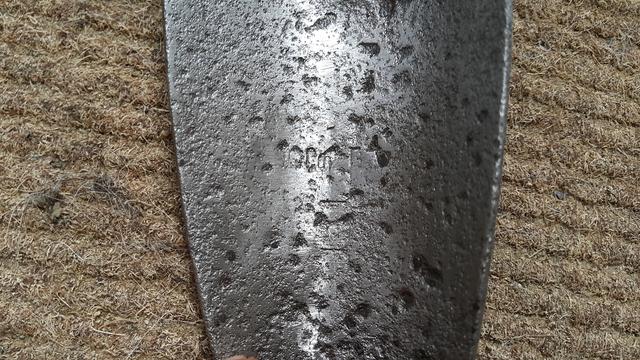

Leave it as is, the pitting looks great, it reflects the life of the tool, both its neglect and use. Looking at the bottom picture, there are still remnants of a depth gauge that’ll disappear if you remove more metal. However, the gauge looks to be in centimetre increments, so possibly less old and used, and more a neglected tool?

Yes it's cm on one side and you can just see the 4" mark on the other. So post 1965 I guess.

I’d leave it as you have it finished to this point. However if you really want it smooth but don’t want to risk taking off too much metal there is an option; fill the pits with deacon then sand it all smooth (much the way you’d mud over the screws on dry wall, or the way we filled bearing surfaces on the KC-135 when the roller bearings on the ailerons wore them down)

I finished the handle off today and decided to fit it. I cleaned up the metal a bit more but I think you guys are right about not going too far and removing some pitting isn't going to improve matters much if there's always going to be a lot on there anyway. Anyway here's a quick before and after montage.
