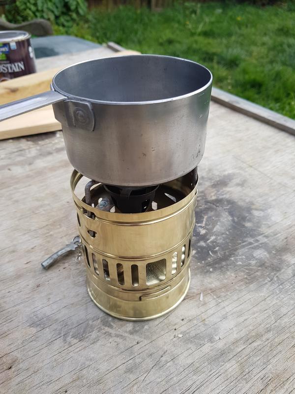

Years ago I used to have a Svea123R which I used when I did a couple long walks. I really liked the stove but sadly it got misplaced during various house moves :(
Anyway I was on Ebay at the right time and with sufficient funds to bid on one which I was lucky enough to win :)
It needed some work cleaning it up but with my trusty dremel clone, some buffing mops, Brasso and some hard polishing it came up pretty nicely.

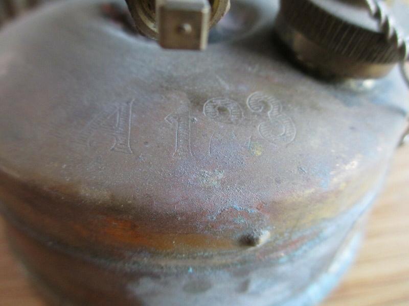

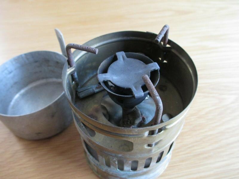

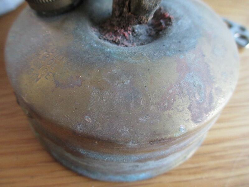

I didn't take any before pics but the seller did and I've used them to give you an idea of what it was like on arrival. Pretty corroded in places with verdigris which proved pretty hard to remove
Well after a lot of work on it it now looks like this :)

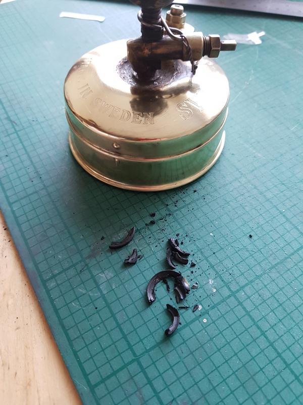

The first time I fired it up was rather interesting as I discovered it had a leak from the filler cap and during the pre warm this started spurting fuel out resulting in some rather spectacular flames :eek: and me dashing around looking for something to cover it with to put it out :lmao:
This was the seal on the filler cap when I removed it so you can see why there were problems
Thanks to the kindness of Charlie Brookes who sent me a couple replacement seals the next firing ended with this and me very happy :)

the Verdigris around the burner is often caused by people using the scented alcohol hand cleaning gels for pre heating. I tend to use a small amount of petrol using a pipette or meths. If the gel residue is cleaned of after use before stove is stored it may not be a problem

Hi Charlie, the vedrgris I was referring to is actually on the top and side of the tank and on windshield. It had actually caused pitting in the metal which was a bugger to polish up.
