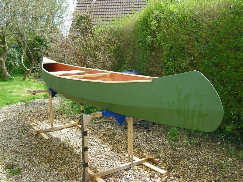

Right - If anyone wishes to take a look or have a paddle of of my canoe, I'll be taking it to the meetup at the end of the month, and you can all druel over it and massage my ego :D or laugh :confused:

Of course!!! :rolleyes: Sorry, didn't realise, I obviously saw it when the thread was new. That does look like a really well made and good looking canoe. How about some photos with it on the water then??!! :D

Here ya go :D
and
Cheers
Rich

Droool, sweet candy (in a homer simpson voice!!)
Looking very good, nice to see the life jacket too, sets a good example! I've got two on order for the young 'uns, and then they can accompany me on pleasant journeys on the many lakes around here, thus giving the missus a break!!
Canoes rock!!

Yeah She paddles beautifully.
The photos were posted to the gallery some time ago. Unfortunately the disc containing the images of the build has got corrupted -It actually looks like its been attacked with a cold chisel ! So these images only survived as they were on the computer :(
