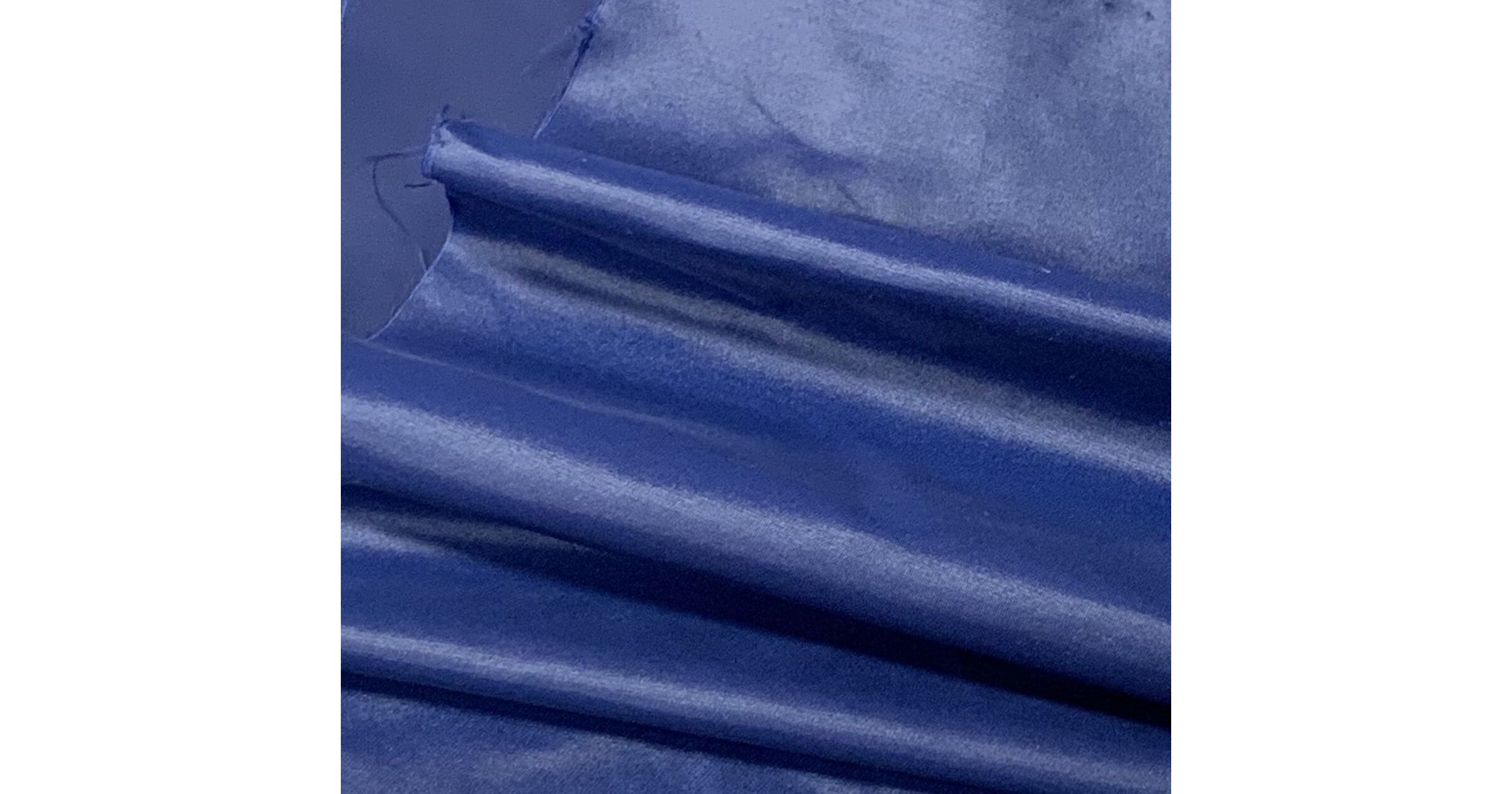

So options are
£44
https://www.profabrics.co.uk/products/thinsulate-cs150-insulated-wadding 174gsm
https://www.profabrics.co.uk/products/skylon-lightweight-nylon?variant=31188856406105 55-70gsm
Or the Climashield Apex, probably 133gsm with either a coated ripstop or a lightweight ripstop one side and silnylon the other. This though costs between £65 and £90 depending on the fabric and website.
Not many comparisons between the two insulations, what I'm really interested in more than the weight is the packability to warmth ratio as it's to use instead of my PHD Minim 300.

I have only read a little on the matter, but that suggest that Thinsulate is meant for insulating clothing and performs poorly as sleeping insulation. As someone on one of the US forums said, "there is a reason that none of the cottage quilt makers use it." In clothing it is important that it not compress fully at joints, so that even when bent it still insulates. That is different from what one wants in a quilt. The CS150 thickness of just 1cm is also at the low end of loft for a quilt and the weight of 174gsm for that thickness is really high. I used two layers of 3.6oz (122 gsm) Climashield and would agree with the quoted loft of 2.3cm max per layer when I made my under quilt. Consider how much loft even a summer weight sleeping bag has.
While weight may not be the concern, I cannot think of anything that provides down-like loft and packability and is also really heavy ;)
Regarding the use of silnylon for the outer, I am not sure that is a great idea. Breathability is important for quilts and bags.

Yeah I did think that with the Silnylon have looked at all sorts so far. the Skylon or similar is looking most favourable at the moment unless I can find someone selling Pertex but that's unlikely.
With regards to the weight it was more to do with if you had a couple of materials with similar properties, the one that can be compressed the most would win.
Did you use two layers of Climashield rather than one to try and increase the air trapped or was there a price implication at the time??
There are some other places selling Pertex in the UK, if you are okay with brighter colours.
I can't remember all my thoughts when I bought the Climashield I used for my underquilt. I made it at least five years ago. I bought from Extremtextil, and I am not sure what options they had at the time. I know that when I got it, I realised that a single thickness of 133gsm wasn't going to be enough for what I wanted, and that 60" was pretty wide. I think I may have already been thinking about creating a tapered asymmetric underquilt that would put insulation only where my body was lying. There doesn't seem much use in having shoulder width insulation all the way to your feet. My original layout didn't work very well and I had to make some adjustments. The end result still has fabric flanges without insulation around the perimeter, but much less than my initial design. This loose fabric can be tucked under me a bit when I use the underquilt on top of me when on the ground.

Just ordered some Climashield Apex 133 and some 10D nylon with a DWR coating. insanely light at 22gsm. I'll let you know how I get on.
