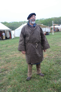

I'm toying with the idea of making my own watchcoat out of waxed cotton as they look fairly simple to make.
Unfortunately my googlefu is letting me down so I was wondering if anyone has a pattern for one or a link to where I can get a pattern from.
Incase you're wondering what a watchcoat is here's a picture of one :)

Looking at that (and particularly the lower sleeves) basically he's made a T shape and sewn it up, then found his arms were sticking out. That's normal from 54 or 60" wide fabric.
Most fabrics aren't wide enough to go right across your shoulders and down to the wrists in one piece, unless your making for a child, so that extra fabric is a necessity to make the sleeves long enough.
So, someone has looked at it and realised that fitting on a straight bit wouldn't work properly and carefully cut a sort of wedge shape to sew on and thus level the cuffs for him.
The front isn't even buttoned, it's just folded around and belted closed.
The fabrics are wide enough to wrap around the body though so long as the measurements are under 54" or 60".
We can get around that by cutting out along the length, but then you get a seam across the shoulder, which can leak, which is generally not wanted in a waterproof garment.

It can leave very wide sleeves though, so generally we make gores from narrowing the cuff to something sensible, and adding those onto the underarm to make more give, saving fabric and wasting none of it :)
That watch coat doesn't have that though, it's sleeves are to my mind too wide at the cuff. Those will catch everything from wind to everything you pass.

The photograph is from our US based company Tentsmiths.
Canterbury did a review and later
A prototype with attacked hood.
Tentsmiths now offers a detached one that makes you look like the Hangman in BLAZING SADDLES.
