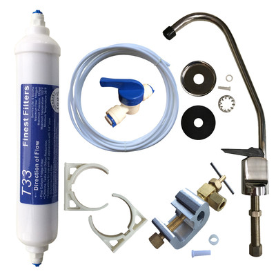

It got so noticeable to me that I bought and my husband fitted an undersink water filter system.
It is simplicity itself, and it gave us back plain as unadulterated as possible drinking water.
Under twenty quid for the whole thing, and that includes the tap and the thing to cut through the stainless steel sink beside the other taps.
I've been meaning to look into something like this.
Honestly, this was so simple a set up to fix. Changing the filters is very straightforward too. I can taste when it's time to change even though I do mark the calendar.
For us it was, and is, worth it. I'm going to fit another in the upstairs bathroom when we renovate.
I'm sure there are other systems, but this works reliably without fuss, without bother, no jugs, no hassle. Very practical.
