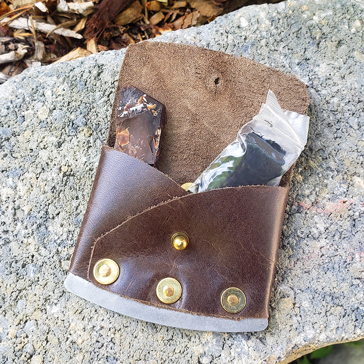

This is a decent modern rendition- it has the integral striker. Not a bad price either- £23
Aye that is a rather decent modern example and I like the way he has made it clearly trapping the steel to the pouch by way of the rivets as I had wondered how the antique example had done that.
Aye and it would appear various bushcraft suppliers have had a similar idea and there are various others scattered around the internet also exploring the rather sensible concept
Chuckmuck - Leather Fire Steel Tinderbox Pouch - 85mm - Beaver Bushcraft & Leather
