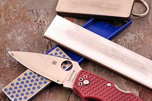

I would go with the DC3 for field carry. I've used mine a ton of times for exactly that. I usually don't spend a lot fo time sharpening in the field in the first place. If you are just touching up a blade, a small stone works well. If you put a proper edge on the knife to begin with, it should hold up well for a few days in the field unless you abuse it. It just depends on how hard you plan to use it. Unless your knife has a blade with a high rockwell, say 61 or higher, a small hard arkansas stone or some good sandpaper is usually all you need to lightly touch up a blade in the field. A good small strop is perfect for most chores. If you are doing a lot of butchering, a knife with softer steel and a sharpening steel can be pretty handy.
Below are some of my favorite field sharpeners. The DC3 is the top one. I also really like the double sided Spyderco ceramic hone. If you are carrying hard steel like ZDP189, diamonds are your best friend. ;) Diamonds are aslo very good for putting a toothy edge on soft steel butchering knives.
