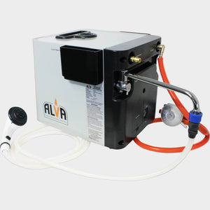

I may be building one of these - Have the IBCs already and need to make it ready for early next year.
My main question is as its a bit of a mash up is how best / easiest and that worse of words 'safest' way to get hot water provided and delivered in a controlled manner as to avoid the "freezing cold-turn the knob 3mm-instant scalding stream of lava" type feeling we all enjoy and love.
Now I know there are plenty of clever gadgets available - so what would be the quickest and easiest fix?
I'd imagine i will have access to electricity but possible that I don't .
Any heaters that work straight from a Gas bottle ?

I looked at stuff like this for down in the Shepherds Hut - but decided against it :)

How about a catering sized electric kettle?
20l of boiling water, 20l of water at zero... 40l of water at 50C?
Maybe have a look at a donkey
Water donkey
Whilst I don't think this would suit my needs for a shower - I'm interested in what this is - do we thinks its just a giant Ghillie kettle with a tap in . tap out for water?
I have a big empty propane tank here somewhere - so internal chimney with water baffle?
