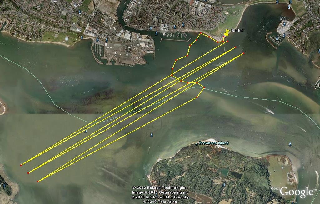

Thats pretty much where I had been sailing after dropping the boyfriend and the route where I drifted and was towed to land, and where I dragged it along the beach.
Mr Captain tipped his over in the bay at the top right of the image.

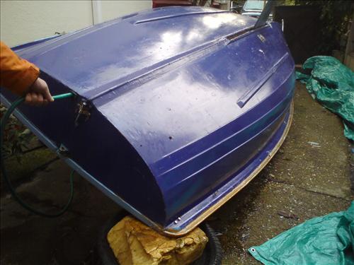

Put some water in it with a hose pipe and watched it run out through the bottom again.

..and watch it run out again.

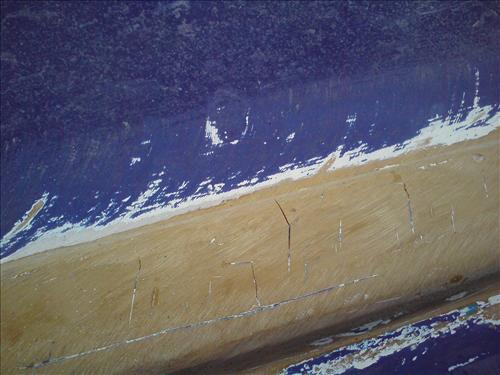

Found I had beaten a hole in the bottom where I had beached it full of water, and scratched it everywhere.
Oh dear....

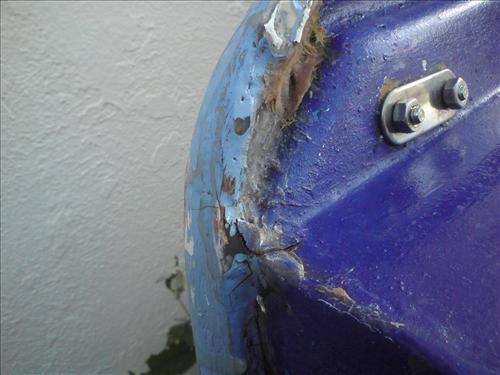

It had also cracked in lots of places.
This was going to take a while to fix.

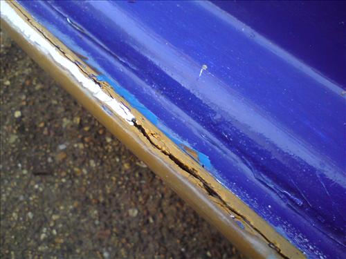

It had even cracked out at the back again.

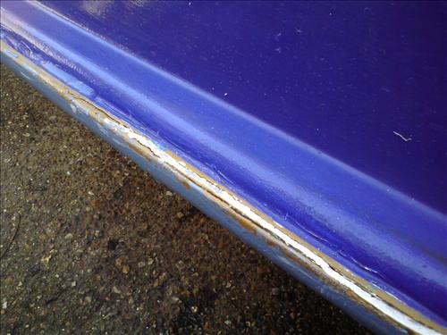

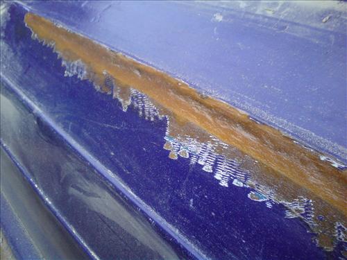

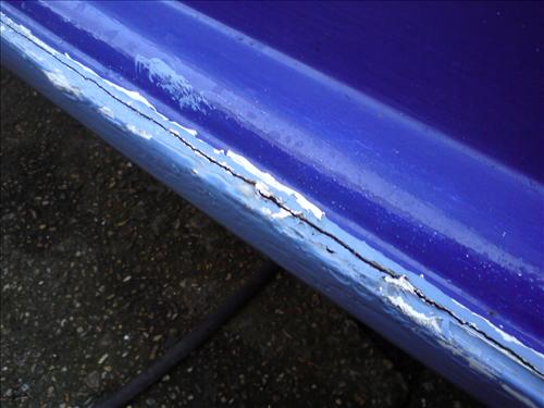

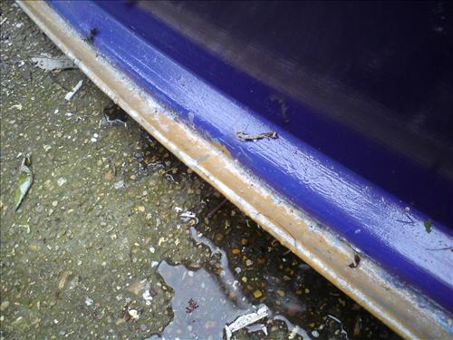

THe white seal along the edge where the hull joins the top moulding had actually parted in some areas and only had about 1 ft in its entire length where it wasnt leaking.
Thats bad.
Heres the crack.
and the other side...

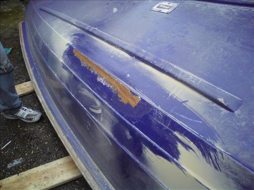

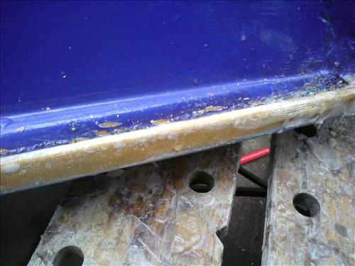

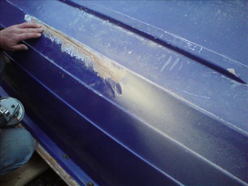

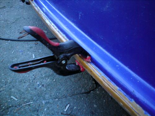

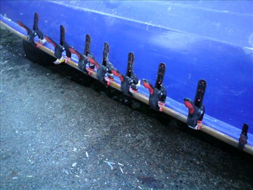

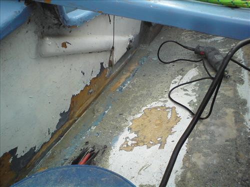

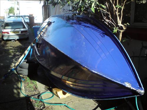

I used a dremmel and groung out the whole length of the joint, so I had a good clean area to fill.
Then I mixed some resin with microfibre to make a filler - something like body filler for cars, and er....filled it.
I had to clamp it to close the slot, so it had a better chance of holding
As the filler kept running into the gap, it took a while to get it filled.
Good job I have lots of clamps

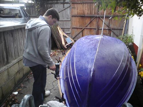

When biggest arrived back from school.....

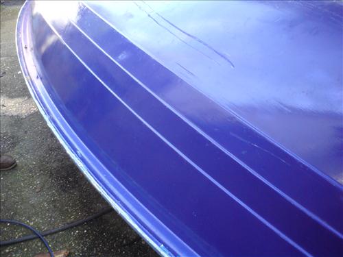

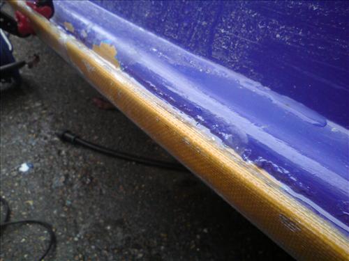

I ground back the outside edges and then resin and taped the joint, several times.

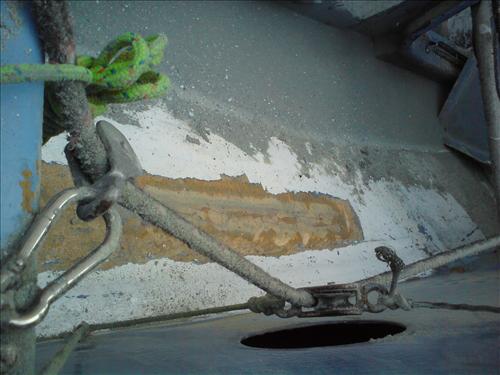

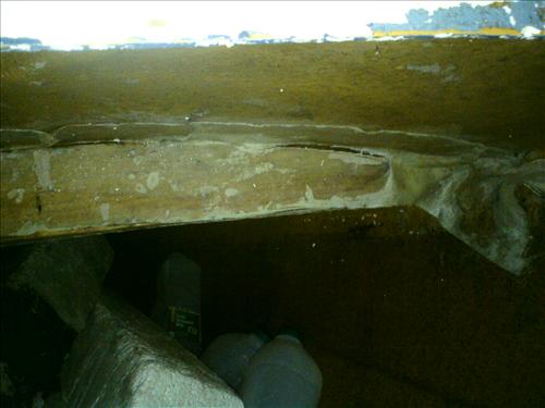

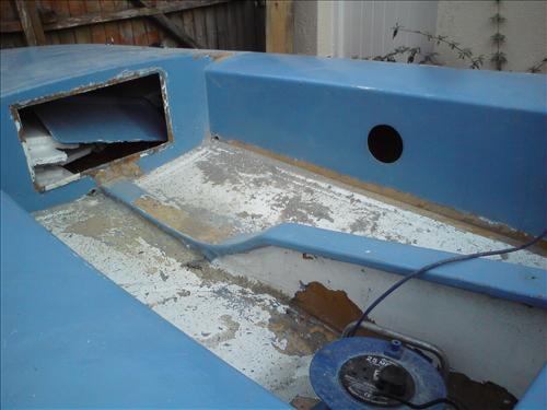

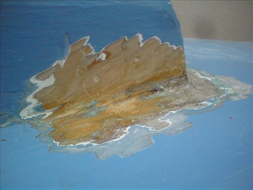

While I was at it, I ground out the damage under the mast step - the thing the mast stands on inside the boat, and filled that too.

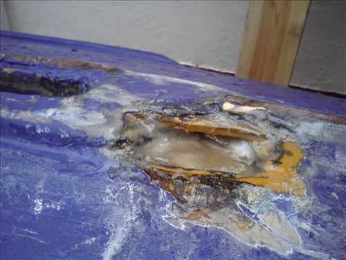

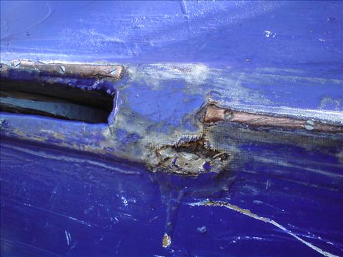

He found a crack here and er....
Thats some crack!

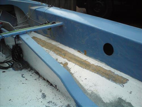

Cleaned out and primed with resin...
Its filled with several layers of fibreglass tape.

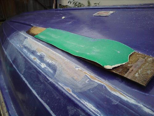

Im using a long board with sandpaper on it to rub down the high spots.
Hate this job.

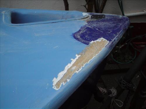

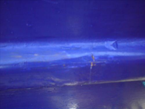

Noticed this was cracked too, so I cut it back...
I just gave this another coat and it rained.
Its rained on this too.
I managed to dry out both with a heat gun paint stripper..

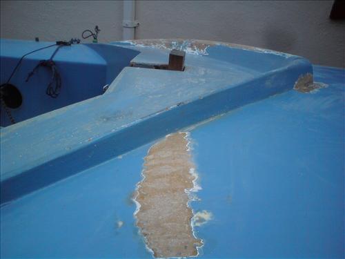

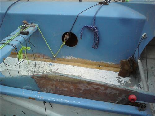

Just discoverd the front deck had cracked again too...
It also cracked here...
and here....
And here on the floor
And here....
The tanks started to crack out too
And here....
and alongside the centreboard box

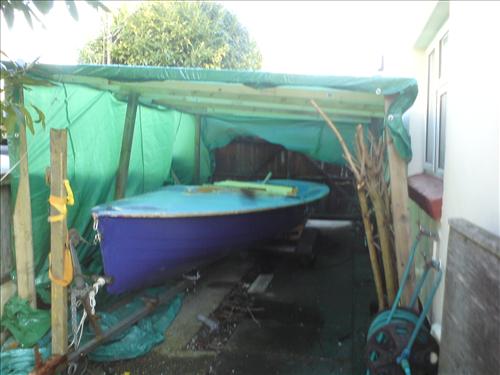

BIggest asked why we didnt just build a lean to...
Why didnt I think of that?

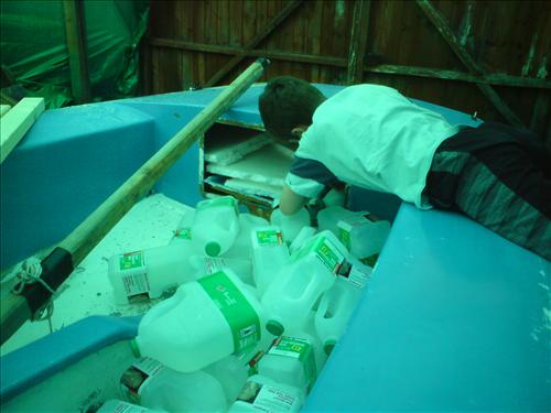

Little one decided that he would use his own Idea of boating to make sure i didnt sink it again.

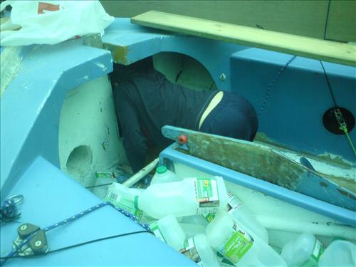

He filled up all the tanks with bottles.
He asked the manager of the greasy spoon cafe to save them all for him.
Hundreds of them.
Thats when he found the deck supports had cracked off.
Took ages to fix them again.

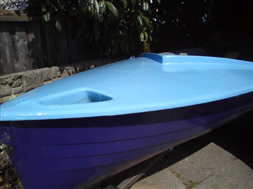

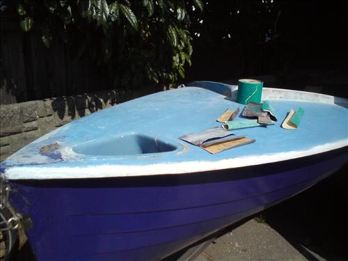

I finished repairing the front deck
and painted it again
Happy with that.

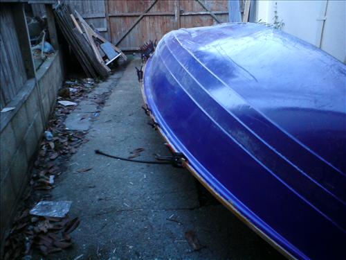

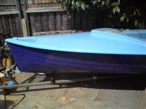

The boats parked outside, all fixed.
It needs some hiking straps so I dont fall off again, but other than that..
Its ready to take us to the trees!

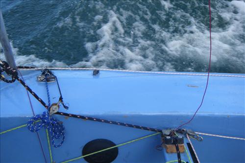

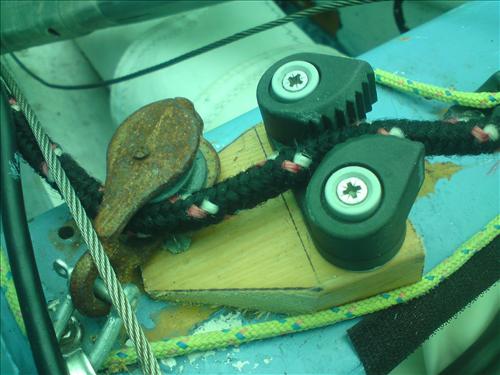

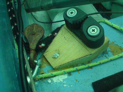

While I had the boat in bits, I decided I should do something to make it easier to pull the front sail in when driving.
Step kid is sitting on the left of the pic, the blue thing going across the middle of the boat is called a thwart - No Idea why, but the rope that pulls the front sail is the thick black one coming from the right onto the thwart
This pic was taken a bit later when the boat was on the trailer. The thick black plastic is the trailer light wire, under it is the front sail rope, or sheet. Again, No Idea why a rope is called a sheet.

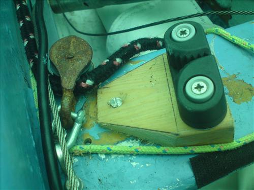

Anyhow, I put the wooden bit on with the spring loaded black things on top. They are called cam cleats. You pull the black rope up through them and pull enoug to tighten the sail. The cleat hangs on to the sheet until you flick the rope out again. Saves you hanging onto it for hours.
If you turn it this way, you can reach it from the back.
This is the rope cleated, as it would be when sailing.

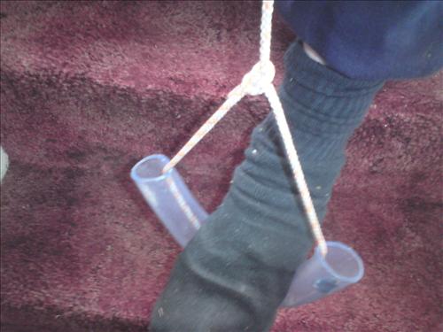

So....

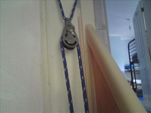

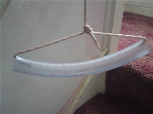

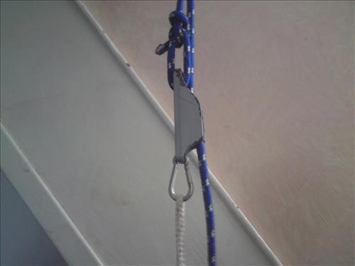

I got this piece of rope and put some inch pipe on it - long enough that I can get my foot in the loop even if Im wearing sandals, or trainers as I will sail in pretty much anything.
I tied the other end to this cleat thing. The blue loop goes up from the top and round a pulley, before coming back down and through the cleated side. You can pull the rope down through the cleat, but it wont slide back up unless you release it.
Here is the pulley at the top.
Ive set it up in my stairwell so I can take pics.
I tie the pulley to the blue bar thwart in the middle of the boat.
If I tip it over, I swim round and throw the pipe over the top so it hangs down the back of the hull.
I stick my foot in it and pull to pull the boat back up, and then keep my foot in it to get a leg up over the side.
