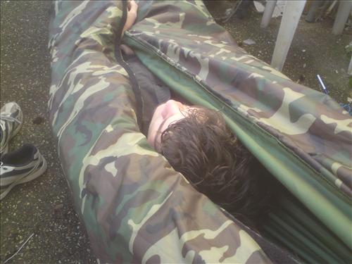

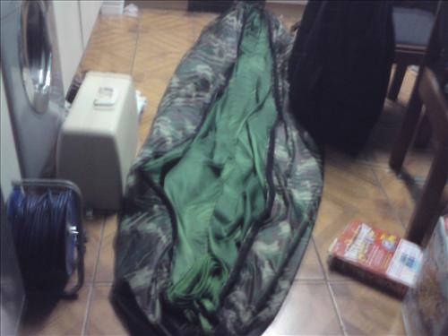

I think th eboyfriend is playing on the playstation, as my biggest seems to have grabbed my hammock again.
You can see the velcro on the side ready for the top to go on.

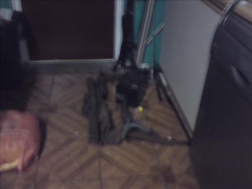

When the tester failed the car, one of the things he failed it on was the towbar being rusty.
I got it taken off so the car would pass the test adn i could get it welded.
Couldnt do it myself because of my pigging ribs.
I wish they would hurry up and shut up.
Thats the tow bar.
Need that back on so I can go tow boats again.

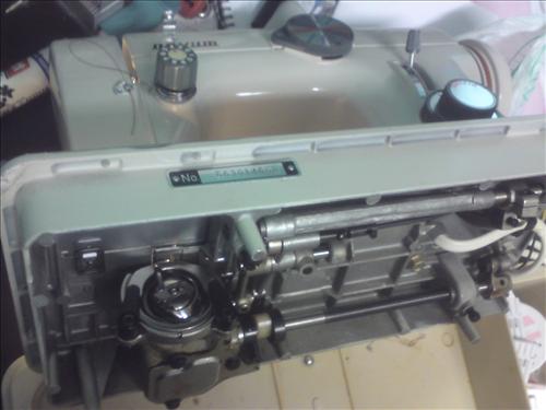

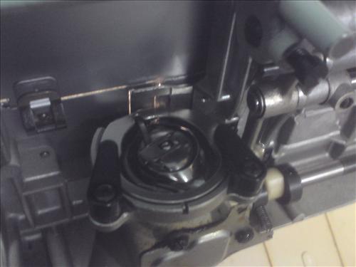

The sewing machine stopped sewing.
Irritating.
It was belting lines of holes in the cloth, but not leaving thread in them.
Struggled with it for hours.

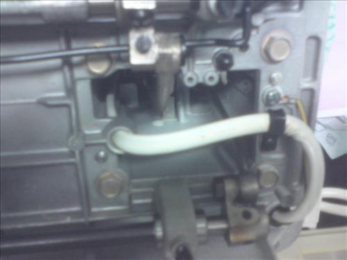

Eventually discovered that the bobin wasnt turning quite far enough.
A grub screw had slipped.
Im not a sewing machine engineer.
I struggled fixing it.
The loose grub screw was to the left of the bottom end of the pipe
I twisted it straight and did it up and was able to carry on sewing.

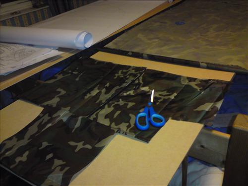

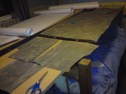

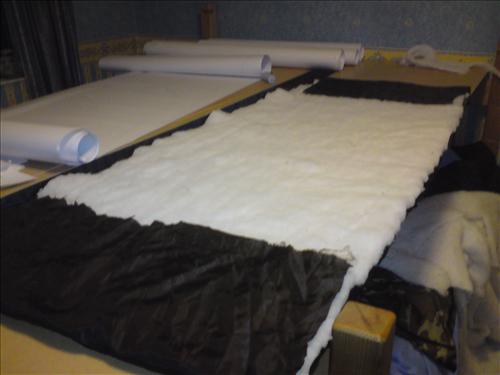

I did some careful measurements while the boyfriend was in it and started to set out the lid.
I think this is what I need - sort of.
Im cutting this out on some hardboard thats stretched over my bed.
The board has been there for several months as Ive been drawing boat plans on it.
This is why I usually end up sleeping on the settee or in the garden.
I need a centre piece, two pieces for each side of my head and then two ends.
Its cut....

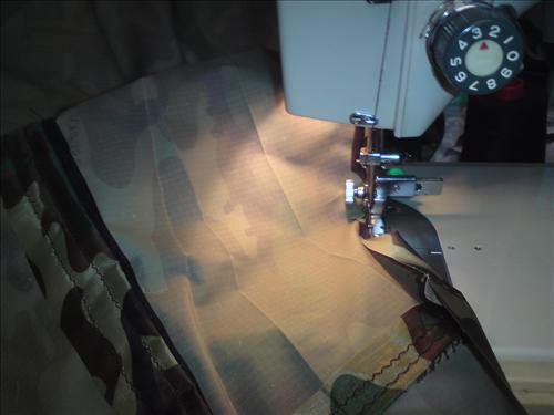

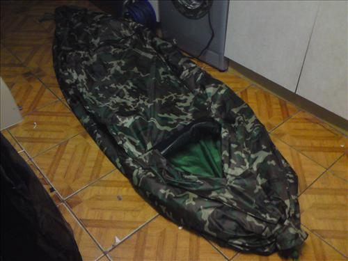

Sewing it.....
Machine slipped again.
Struggled for over 3 hours to put this together..
Grrr.....
I might like hammocks, but I could get to hate sewing machines.
No Idea
Sep 18, 2010
2,420
Dorset

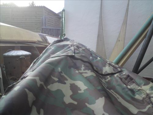

Ive now got an opening both ends so I can sleep either way round.
Cant make up my mind if I want to sew one side on and velcro the other or just velcro both
