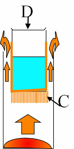

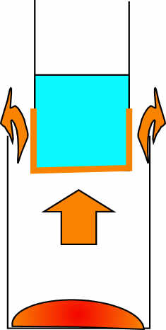

So....
I am guessing....
The heat rises and heats the area of the pot thats orange.
No Idea
Sep 18, 2010
2,420
Dorset
I am guessing that the more area of pot gets heated, the faster it will transfer the amount of heat needed to the water inside.
No Idea
Sep 18, 2010
2,420
Dorset

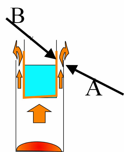

So....
If I lengthen the height of the firepot walls at A, it would increase the size of the heated area at B by keeping the hot air in contact with the water pot for longer....
No Idea
Sep 18, 2010
2,420
Dorset
So.....
Presumably, if I were to stick a computer heatsink to the bottom of my waterpot, I could increase the area of the pot in contact with the heat and so transfer the heat faster....
Thats assuming that the whole lot doesnt just melt.
I was wondering what would happen if I were to put a hammer to several heat sinks and bend them to fit around the outside of the waterpot too.....
No Idea
Sep 18, 2010
2,420
Dorset
I think that putting a lid on the pot, D would stop the water losing heat as fast too.
I wonder if I could insulate the sides of the water pot where they are clear of the fire pot to reduce losses further.
Hmm.....
I wonder what happens if you insulate the fire pot too...althoug, that might stop it getting used as a little brazier in cold weather, so maybe not on that one.

This is still what I am thinking about, and i might alter it a bit, or even a lot...
but...
The green would be fireproof insulation
The sides and bottom of the water pot would have fins to increase surface area
The bottom of the fire pot would contain a mesh to keep the fire from burning whatever the pot is standing on
The water pot would fit inside the fire pot, and the insulated sleeve would pull up the sides of the fire pot and be held up by the skewers the waterpot stands on.
I think....
But as I said, its sort of niggling at me.
Im going to play with it a bit more and see how I feel.
Right now, I feel its too slow and uses too much fuel and is far heavier than I think I would like to carry.
