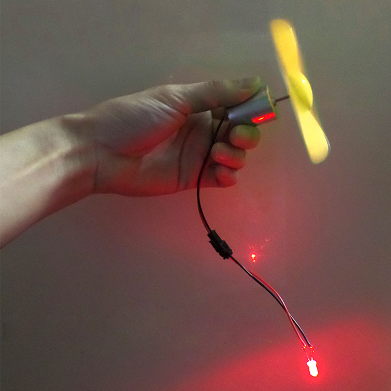

In addition to the above post, I'm currently playing with a cheap £4 USB wind charger off eBay. It requires assembly and cased, so we shall see how it performs. In my last home, wind power was much more effective, especially during winter, and much much cheaper to purchase, and set up. This is of course suited to my previous location, where there was always plentiful wind. The USB charger will be mounted atop a cut down carbon pole attached to my backpack feeding into Lion battery pack. So far costs are under £20. This of course is a prototype set up and if it works ok, then I'll build something better.
Here's the cheapo.
It comes with a regulator but I wouldn't connect it to anything sensitive hence the reason for plugging it to a battery bank which will allow me to monitor the thing, and stabilise it. The "motor" will need to be cases up, and a seal fitted to the output shaft but it should all work, for not much outlay, and a bit of time.
