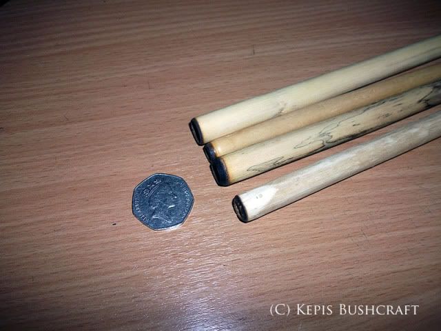

The picture shows the cut off ends from a couple of old drills and half a dozen Clematis boards that I'm sending off to Northern Ireland in the next week or so, so that Abo at Belfast Bushcraft can see how the Clematis compares to his usual hand drill hearths.:)

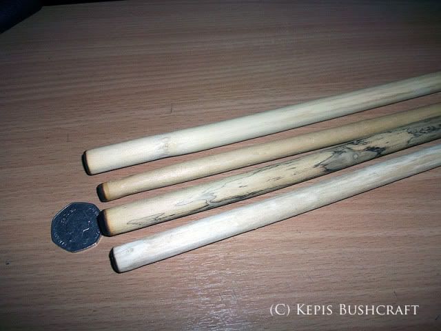

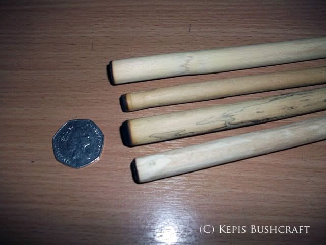

Kepis would it be possible to post some more pictures of the "drill" please, with a ten pence piece or some thing like it for scale...
thank you...
chris.
Kepis, thank you very much mate, thats just what i was after... i now know that my drill is WAY WAY to small its about half the size of a five pence piece across the drill, i think this would reduce the friction due to the size/surface area...
looking at your drills in comparison to my drill, i think i would get a coal with a fatter drill, and using the "V" notch to the edge of the hearth board drill hole not the centre....
