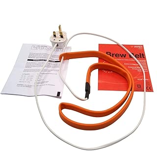

Brewing Bears sounds a bit dangerous, particularly if you keep them warm as that is when they are most active.
I merely mentioned it, not as anything to do with brewing, but how I found out about heat strips. Here's the home brew one,
