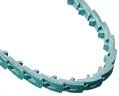

And on old "88's and 109's" for fording deep water, the trick was a an easily removable fan belt to stop the fan from firing water everywhere.
