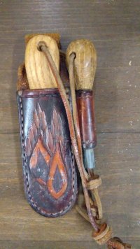

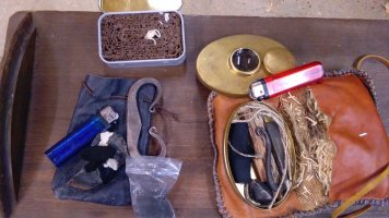

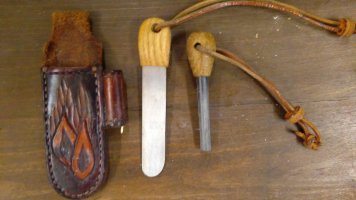

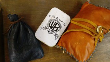

I take bits out or take the whole lot to have a play around with techniques.
Pocket bellows are great and make getting a fire going very easy in challenging conditions
No shortage of flint here to use on the ‘steels’. The small steel is a Dave Budd made for the ‘Song of the paddle’ forum about 15 years ago. The larger one I bought of him at the moot this year. I can get a spark to catch on char cloth or cramp balls. The wallet is a plastic ‘oil cloth’ tobacco pouch. Good to put bits of tinder and dry fragments collected during the day.
I was just sorting some gear when the post came up so everything was to hand.
