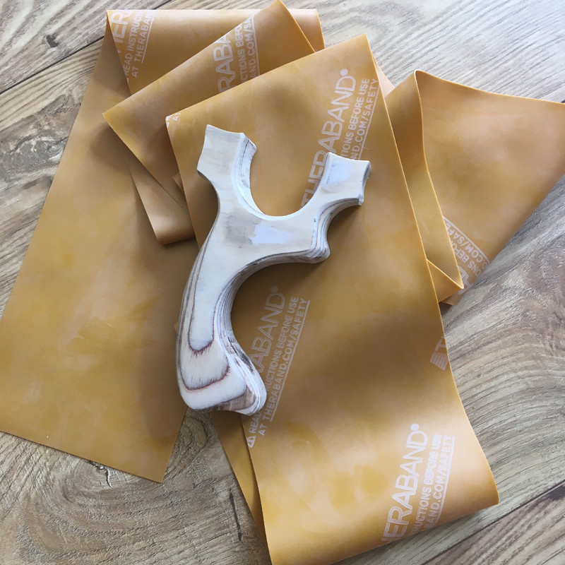

Theraband Gold is the best elastic I've tried. It's that stuff you get for physiotherapy. That particular one is considered by many to be the best and it can be bought in long rolls. £30 for a lifetime supply. It's easy to cut your own bands (DO buy the proper cutter) and it's great fun to experiment with different lengths and tapers.
Straight bands will last a little longer but sacrifice efficiency. Bands which taper towards the pouch are more efficient but less durable. For a hunting band, I'd again imagine you'd want the most efficient you can get since you can cheaply replace them if they break and always carry some spares.
