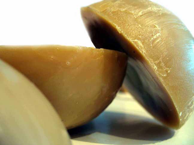

Pretty sure this will do the job and look the part even though it's not specifically called BREWER's PITCH.
