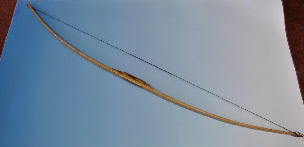

You can make a simple but effective 'Bhutanese' type bow with two pieces of bamboo, joined at the handle. No backing is necessary, but it is a good idea to reinforce the bow nocks to avoid string wear and any chance of splitting the limbs. The draw weight depends very much on the thickness of the bamboo that you can get. You can also directly increase performance of the bow by heat treating the limbs once made, using a heat gun like those used for paint stripping. I made a bow of this type many years back, and it is still working fine. I posted a few pictures of it on Primitive Archer, see my posts in the following link: Primitive archer post
Edit: I forgot to add, in this type of bow the inside surface of the bamboo makes up the back of the bow. That is counterintuitive, but works well. I have handled a proper Bhutanese bow, which was made from bamboo which had more than a half inch thick (12mm) wall, and pulled upwards of 50lb draw weight. With reed-based arrows the performance was extremely good.
I would also strongly recommend Primitive Archer forum for detailed information. It is a US-based forum, but very knowledgeable and helpful.
Cheers, Bob
