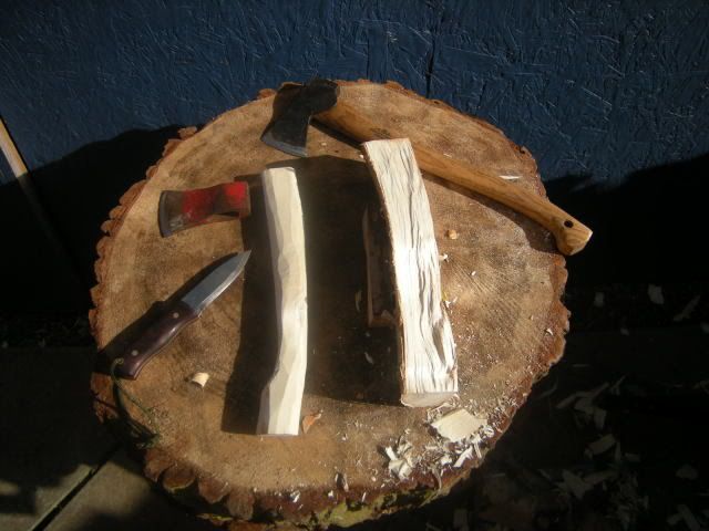

Can green wood be used to fit a shaft on a axe? Which is the best wood to use?
I have found an old axe head in the shed and wanted to give it a handle without resorting to the B&Q "Hickory"
The only problem with using greenwood for axe shaft is that it will dry out as it seasons and the head will come loose.
Prehaps best to rough out a shaft and leave it to dry for a while then finish and fit.
You cant go wrong with Ash for handle.Nice to work,tough and springy.:)
Depends how 'green' it is really...About a month or so...
It wont shrink that much but id err on the side of caution and make it about an 1/4in oversize.When its dry shape to size.
Thanks for the links.
I haven't any Ash knocking about at the moment, although I know a couple of branches that would be suitable. I would rather not cut them unless absolutely essential.
I have some good straight Birch, Cherry and a bit of Apple. Would any of these do? I am only making a small pack axe handle about 12" long.
I recall somewhere that is was as much as:
Most hardwoods - seasoning is about 1yr per inch
Most softwoods - about 6 months per inch
Of course this varies widely due to species, original moisture content and the environment it is seasoned in.
LBL
If your wood handle was made from a split section of log, it will dry in a few day's right next to a stove or airing cupboard, its unlikely to crack it being just a small segemnt out of the main log. Alternatively you could weigh it, note it by writing on the end, and weigh it every so often it will obviously reduce day by day, when it stays at the same figure it is dry. Failing a supply of decent ash I would try the birch as long as its fresh and hasnt stood outdoors for any time, it soon gets spalty and soft. Personally I would save the cherry and especially apple wood's to carve into spoons or dishes or kasa cup's etc!!

I selected a log from a couple I had with a bend in it. Quartered it and then roughed one of the pieces out to dry.
The red one is the head I found in the shed. Is it ok to have a curved handle?
