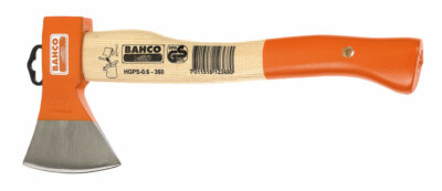

Try one of these back to back, I recently cut through a 10 inch?? diameter fallen tree after i gave it a bit of a sharpen, it did well. The sheath is rubbish as its just a rubber thing to save cutting you.

To be honest, I bought an axe from a tool store. Hickory handle and a 2 1/2lbs head. I use it daily to chop kindling for the fire and out and about when I'm collecting firewood.
Its absolutely fine and pretty bullet proof. Keeps a nice edge, and best of all cost me only £10.
My origional axe was given to me 40 years ago, and is still going strong.
It was second hand as far as the chap that gave it to me, had inherited it from his father.
You dont have to spend a fortune on axes.
Yes I'd like a "bushcraft axe" but I wont spend silly money for a name, when something cheaper and just as useable is available.

This, to my mind is a trap that newbies often fall into. Buying stuff advertised as "bushcraft".
Put that label on it, give it a tactical look, and hike the price, and you are making a small fortune out of people with no experience and only you tube knowledge.
Just go to tools r us or any half decent tool or farm supply shop and you'll get a decent working tool at a reasonable price to start off with.
People who need tools for their jobs such as farmers wont buy rubbish.
Sadly with the increase of on line buying, a lot can be gotten away with as regards to quality as you cannot see before you buy. When they have your money, they can be as tardy and obstrepourous as they like in refunding.
You'll get a perfectly reasonable and useful tool at much more pocket friendly prices , and see the quality of the goods before you buy, if you go to the places I recommend.
It may not be fancy, or look so obviously bushcraft, but it realy doesn't matter.
