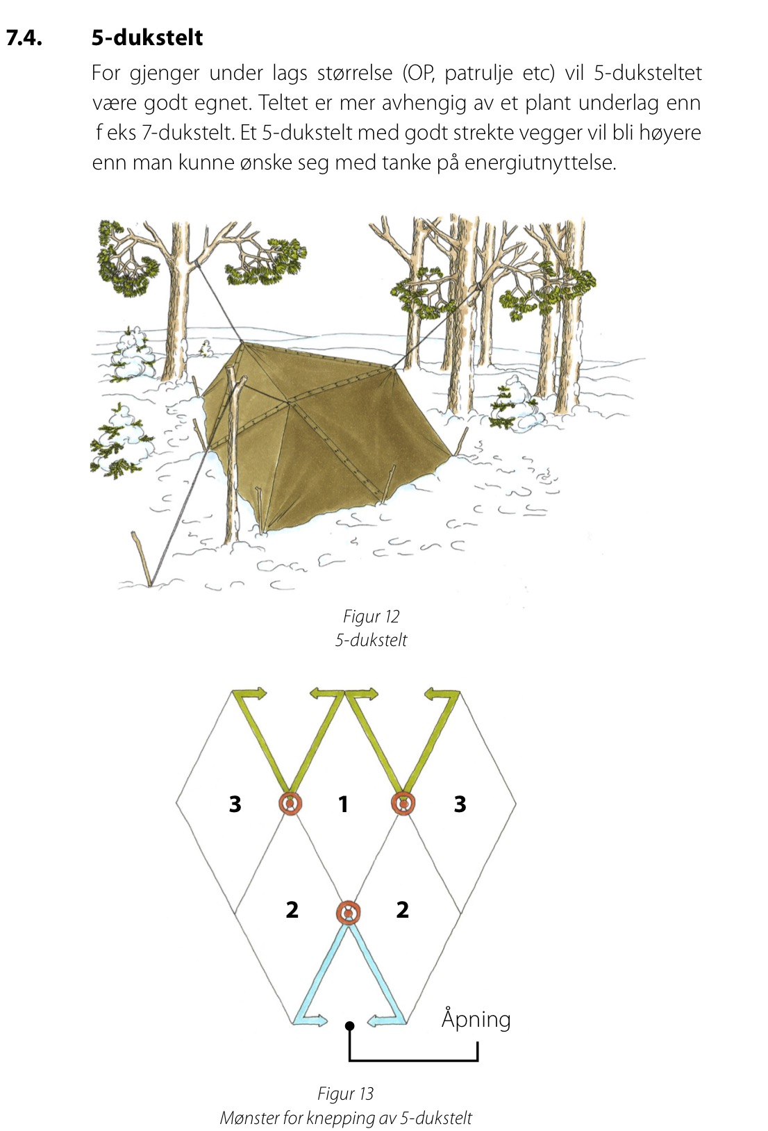

Tor helge
May 23, 2005
739
44
55
Northern Norway
www.torbygjordet.com
Some more info (it seems my earlier link is broken).
The norwegian tarp is diamond shaped. No other shape was used.
The tarps could be green (most common) or camuflaged.
Each tarp is about 1,5 kiloes.
The tents mostly used was 5, 7 or 10 tarps tent.
Only at special occations was anything else used.
Rifle teams used 5 and 7 ( pictures below) tarp configuration, and AT teams mostly used the 10 tarp configuration.
images
When I did service, no one was buttoning up these in the field.
They were carried ready made, rolled up on the rucksack.
I carried ours, a 10 tarp tent (below).
images
The sides were buttoned in a fashion called "stormknepp" and roof (the number 1 tarp in the pics) standard double buttoning (pic).
No tent poles were used.
The tent was set up using trees, cut tree poles or skiis (pic below).
main-qimg-ceb6e3a2cfbf20d8cc461ecaa67bd9b6
The issued tent poles was sometimes used as candle holders.
Tent was heated (cold months) with the Optimus 111 hiker kerosene stove.
Each team usually had two stoves.
One man was manning the stove at all times. Usually the hour before one went out on guard duty.
