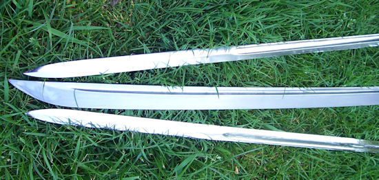

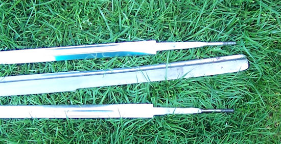

One of my Katana blades, and a matching pair of rapier blades (tips then tangs):
I cheated outrageously by running the fuller on the Katana right along the length of the tang :rolleyes: - at well over 2,000 layers and all forged with hand held hammers I was knackered enough to justify that decision...
It also changed the balance slightly and I am happy to report that I like it that way :D
The rapiers are going to be a matched pair (one day) and are forged 5160 with forged in fullers. The hidden tangs are also forged down with the ends reduced and annealed, then threaded. Furniture will be Sterling silver, and I made three matched blades in anticipation of balls-ing one up royally which, so far, I have managed to avoid (famous last words) :D

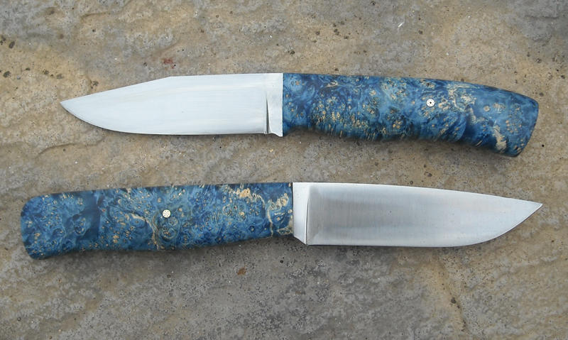

And, back to knives, a prototype hidden tang:
Notice how far back the pin is - I usually make my hidden tang knives with the tang between 2/3 to 3/4 the length of the handle material which, I guess, goes a long way to explaining my confidence in my hidden tang knives :)

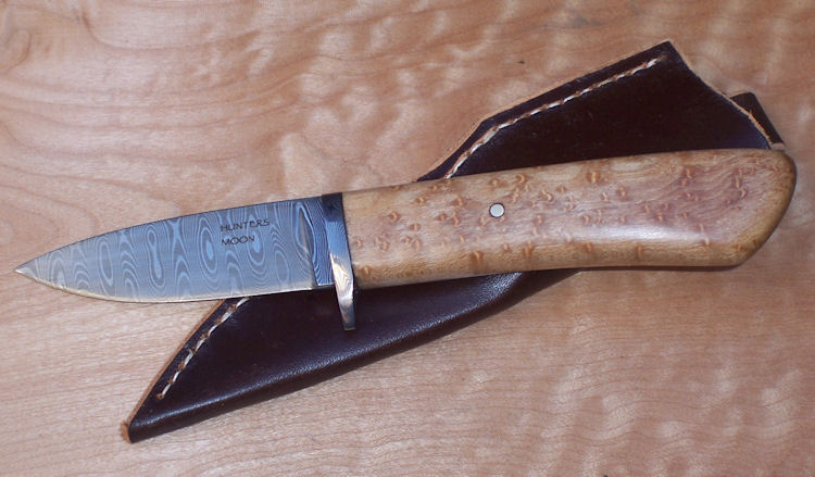

Hidden tang Damascus (blade and guard) with Bird's Eye Maple handle:
You get the idea by now - in case anyone was left in any doubt, I remain partial to hidden tangs but, at a push, a full tang is acceptable, if hidden is not an option :D
