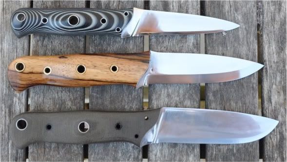

Top is my Flandi gound DSP this time its the 7/8th scale First one ive done its from 6mm O1 with Midnight tiger stripe (black n grey ) G10 i finally gotthem to Make it in 3/8" thickness afet moths of badgering :D
next is a full size DWC woody clone with thick wall tubes and Zebrano scales this has a taper tang to 2mm
then a new idea Flandi ground out of 6mm with Green Canvas Micarta with Carbon fibre and stainless tubes has the full size handle btu the thumb ramp has been slipped fwds which i quite like so may try on others:rolleyes: no taper or drilling on the tang soe a good solid handfull

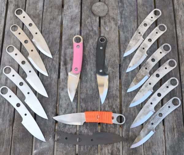

This balde shape is a bigger project for a freind but hes allowed me to play with it as well fairly simple shape with lots of Pimping potental being Lazer cut allowes bolt on bolt off swappsies scales etc
the main use is for a bare blade these have rounded tangd for comfort and can be easily paracord wrapped
with square spines ive tryed a couple of variations on bolt on scales one in Pink G10 ( Forthe ladies ) and a one in Black linen micarta with a push fit 15mm stainless lanyard hole
alos been trying different grinds to the main are Scandi ground the pink one is Flandi groind and the micarta oen is Convex ground
