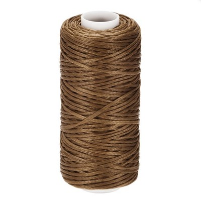

The thread arrived today, not what i was expecting. Its half the size of the spool and thread is half the size again compared to what I used. will be ok for something else.
I think next time i'm going to get proper specs as no one seemed to want to tell you the thread diameter and spool dimensions. etc.
Yes mate, no reflection on what you said. it is really strong, and now I think about it the thicker thread I used (most likely waxed linen after a search) was for leather work I bought years ago. would be nice to get a poly thread the same diameter for heavy cordura work.
I am totally clueless when it comes to sewing and threads etc.
That thread on the right is VERY heavy.
The guterman stuff will be fine tbh, it’s surprisingly strong - I use it in a sewing machine
Yes its almost nanocord :) . I asked bez on YT what and where he gets his. its 1mm 150D waxed polyester thread. I think the hole size created by the awl is so big it needs a thick thread to be able to keep tension maybe??
Reactions: MrEd
Yep that’s right, a big needle with small thread would be rubbish and look terrible aswell
