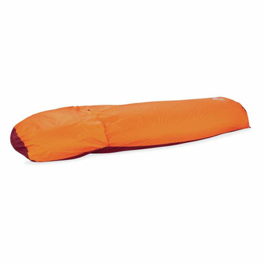

My brother loves hiking in pretty high areas in Austria and often enough he does it alone (what usually isn't a good recommendation, but he is very experienced and can risk that).
I would like to gift him a really good bivvy bag, like the Snugpak Special Forces bivvy bag, the Carinthia Goretex sleeping bag cover of the German Army or the usual British Army MOD Goretex bivvy bag.
But I think in this special case I should buy a bright orange or red one.
Most stuff I have seen in red or orange had been constructions I find not really convincing. And most aren't moisture permeable.
What do you think about this bivvy bag here, the Alpkit Hunka XL?
Does somebody own an use such a bivvy?
Can you recommend me other similar constructed moisture permeable bivvy bags in red or signal orange?
I would prefere one with a central half length zipper by the way, because he could use it very well in the tent too, but a cut like the MOD bivvy is good too of course.

I've used the Hunka for a while for certain things - where weight and size meant it was better suited than the british issue one or a hooped one i have. Certainly very light and compact, and i've never had breathability issues. Personally, i'm never convinced by the worth of a zip in a bivvy (well certainly in a bivvy that doesn't have poles) - i've never struggled myself to get into a bag without a zip, and i just think the zip adds a weak point, a potential route for leakage, and a little extra weight/bulk. Certainly, if your brother would be looking to use the bag as a bit of safety kit, then the non zipped Hunka XL would seem a great choice. It's clearly not a particularly heavy duty option, but that said, i've probably slept 30+ nights in mine, including a few on concrete, and it doesn't look any the worse for wear.
I have the standard sized hunka - just about fine for a 2 season sleeping bag, but would recommend the XL for use with 3 season + bags so the loft isn't compressed.

In central European summer conditions a central zipper is a good idea, because the open bivvy bag can protect the sleeping bag too if it's so warm that ventilation is needed.
But the intended use is mainly an emergency and bad weather option, and so the Alpkit Hunka XL is the best looking I found, because obviously one can really close it until only the nose looks out of it.

Regarding the panel flying away. Yes, possible, but on the other hand, it is so small and light that it is unlikely to ever be left at home, unlike even the lightest bivvy bag might be. Where it goes depends on how it is anchored. Bear in mind that Jerven provided hi-viz and retroreflective panels with their bags, which are intended for people above the tree line in Norway. Actually, Jerven do bright orange bags too, although they are not what you were looking for, they are very good and might make a good gift in and of themselves.
Several people here have various versions of these things and Stuart has used his from the Canadian winter to the salt flats of Botswana with great success. Heavier than the Hunka, but arguably bore versatile too.
The Hunka is currently going for £55, while a SOL Escape Lite vented mylar bag is £45-£50 at about 1/4 the weight. Meanwhile, both Outdoor Research and MSR do orange emergency bivvy bags that are half the weight of the HunkaXL, while being 3x - 4x the price. (MSR Pro Bivy & Outdoor Research Helium Emergency Bivy).

I think you are right that the Hunka would be better than the other bivvy bags I found. At least it is a design that could be used for camping when he wants to camp. The other, more expensive or lighter weight options are more aimed at an emergency, but by the sound of it, he doesn't believe that will happen to him, so probably wouldn't bother carrying gear that is primarily intended for emergencies. Difficult for you to successfully buy him something that will do what you want if he doesn't cooperate! :rolleyes3: :lmao:

The SOL seems to be less waterproof and less moisture permeable then the Alpkit Hunka, isn't it?
I have the impression that except of the Alpkit Hunka all the currently offered orange or red bivvy bags are very light but not as waterproof and moisture permeable as our usual Goretex military bivvy bags.
I think that the orange mountain bivvy bags aren't really meant to spend a comfortable night in them, more as an additional over bag for weather protective clothing as a wind shield.
If I look in the details, and compare them with the bivvy bags of NATO mountain troops, the usual orange ones seem to be meant to die a bit slower.
I always read things like "relatively waterproof in light rain", "a bit less condensation water inside as usual", "well working if opened wide" in the descriptions.
A Snugpak SF or Goretex military bivvy bag is simply waterproof and moisture permeable and stays it. I can eat inside nuts for several days without becoming uncomfortable, as long as it has a zipper to pee out.
