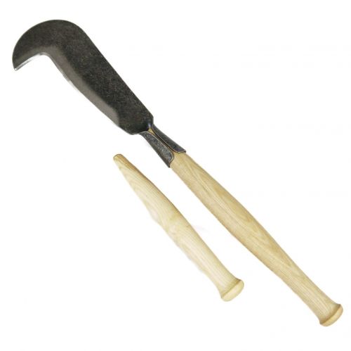

I am tempted to say whatever works, use it, you will find out soon enough whether it is suitable or not. It is not as if there were only ever one pattern of billhook. My Elwell slasher is like a cross between a billhook and a thick machete, it works as well as a bill in some situations. I also confess to using all sorts of things for purposes they were not originally designed for, but they were available at the time.
I have an Italian made one with a leather stacked handle. Longer than a traditional English and as above a cross between a bill and a machete.
I’ve cut h miles of hedge with it and cleared a fallen willow in pretty short order too.
Closest I’ve seen in the UK is the Stihl ones.
I have a more traditional one I bought a few years back but it arrived unfinished as they often do so still needs the blade profiling.
That’s nothing like the Fiskars I have.
The old coppicing boys who I used to cut Chestnut for the NHS walking sticks with a few years ago quickly moved to these as tool of choice after years of Elwells and more traditional ones. They're called handbills in Sussex.
These things are slim stock and the handle can put a lot of force behind the blade, they work very well. The hole can be annoying if it snags, it’s something to do with stacking for heat treat to prevent warping, same as Skrama blades.

That looks very usable to be honest - handle length is good and they've not done anything too weird with the blade geometry and shape. Light in the handle and some nice forward weight.
Rather annoyingly - THAT design seems to be now usurped by Fiskars latest weird looking billhook that looks like a weird homage to the Predator films.
