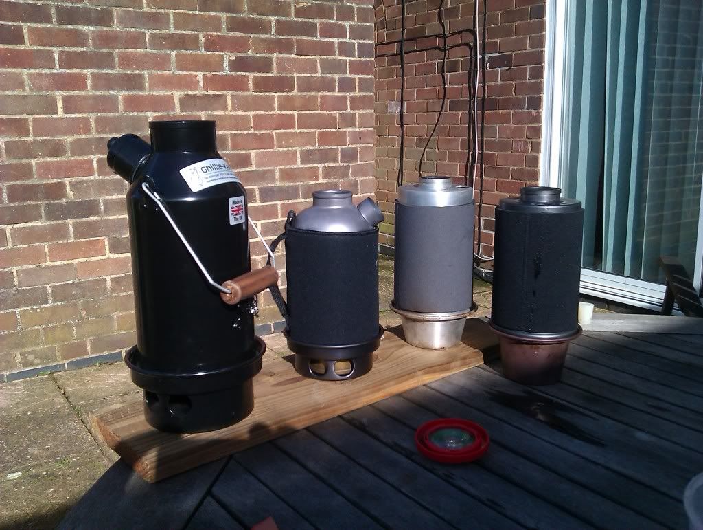

All the mini kettles next a Ghillie Mavrick kettle ,just to show the size difference.

But basically both of these kettles have been redesigned from the old fisherman type kettles that are made and sold by Kelly, Storm, Ghillie and Eden. For the backpacking community so that it was smaller, lighter and more portable. The differences between these and the original type kettles is the top of the kettle has been flattened out and the carry handles and chains removed and the water nozzle was also removed leaving just a round hole in the top of the kettle next to the chimney. The cork was are place by a rubber stopper that can be used to keep the water in the kettle whilst in transit making it a water bottle as well. And lastly a Neoprene sleeve which surrounds the kettle so you can pick it up without burning yourself.
Anyway, we did a comparison between them in his back garden aided by a few cans of beer...well, fosters. We decided that they were both very similar in cooking times both around the five minute mark and look very similar the reason for this is that the mkettle design was well,sort of err....borrowed from the maker of the backcountry boiler.

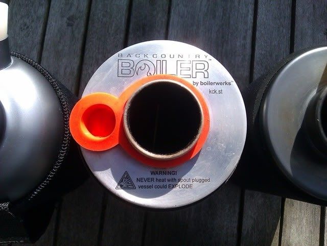

Ok as I have already said the boiler and the mkettle both have a flat top which has the hole for water to go into.The hole on the mkettle is 19mm across and the backcountry boiler is 22mm. The fact that when the water is being poured out ofthe kettle the air is trying to get in to replace the space left by the water. This can cause a bit of a glugging effect and the water can get sort of splashed around a bit when being poured. And if you try to pour it slowly it will just dripple down the side ofthe kettle. On the mkettle is the slightly worse because this hole is the smallest. This is something that just happens on anything without a nozzle. But on the F1 kettle with its nozzle the water pours smoothly all the time as it doesn’t have the problem of air and water trying to pass each other.
Another thing to be aware of with the holes is when filling the kettle if you are not careful you can spill some of the water when trying to fill them.
These are only really small issues but ones that are worth a mention. But that is what you get when you are trying to save on weight and remove the nozzle
The stoppers are used to plug into the kettles so that you can carry water in the kettles during a journey. You just have to be careful not to knock the stoppers out. I filled them all up and gave them each a good shake to see if they leaked or the stopper fell out and I happy to say neither happened.
The stoppers that go in the mkettle and the F1 are made from a translucent silicone food-grade non-toxic Stopper that is usually only supplied to the pharmaceutical industry. And the backcountry boiler also uses a Silicone Stopper which made to last at high-temperatures, this one is fitted with a loop that will go over the top vent of the kettle it can be kept on the kettle even when in use...just don’t leave any of them plugged in the when using the kettles
As for the amounts that each kettle holds the mkettle and the F1 both hold 0.5 litres but the backcountry boiler kettle holds a full pint. This is 56 ml in difference between this and the other kettles.

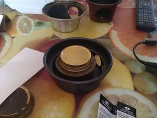

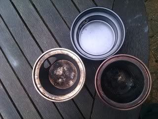

And now I will get onto the firebases
I would just like to say at this point that if you are not being aided (Cheating) by using firelighters, hexi blocks or something else similar. Then getting these to light can really test your fire lighting skills if you are to not use to lighting a fire in a smaller area. I know it’s taught me a thing or two.

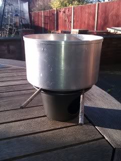

The bases are what stop these kettles from being a one trick pony as you can use the bases independent from the top part of the kettle. All you need to do is get a couple of tent pegs to give it a gap at the top and voila a mini cooker. All these are different aswell the mkettle is the tallest but it also the narrowest at the bottom. The backcountry boiler is only very slightly wider and shorter. But the lowest of the three bases is the F1 it also has the widest area to have your fire. The only issue I found with the F1 base was when using my Trangia as it is nearly flush with the top of the base. So I think I would have to put second layer of tent pegs on to give it a bit of space to breathe so to speak.
Saying that you can get also get stands that sit on top of the mkettle and the backcountry boiler so you can heat pots on top of them but you have to make sure that the kettles are full of water so as not to damage the kettle and that ok if you are after a brew as well. But if you just want bacon butty that is a bit of waste of time heating up all that water as well.

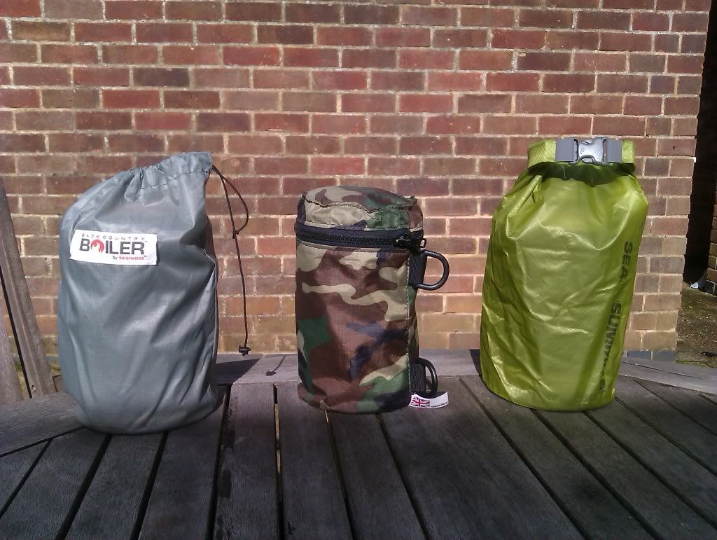

As for the carry bags the kettle makers seems to have gone in different directions with this one the backcountry boiler makes his own bag which is ok but it is nothing exciting. Where as storm kettle are supplying a 2 litre sea to summit dry sack as they believe that these are the best quality and well known brand in the UK (The bags having won 'editors choice' awards in the past). Also Storm kettles told me that they will only substitute this current bag with their own label when they find a superior British manufacturer to make their bags for them. And finally there is the mkettle bag the one I have is a camouflage coloured one with a zip around the top, but the normal bag is black but they have stopped fitting the zip now and are using a pull tie to keep it closed.This bag also has two ‘D’ rings fitted on it so that it can be attached to a back pack or a push bike or to whatever takes you fancy.
