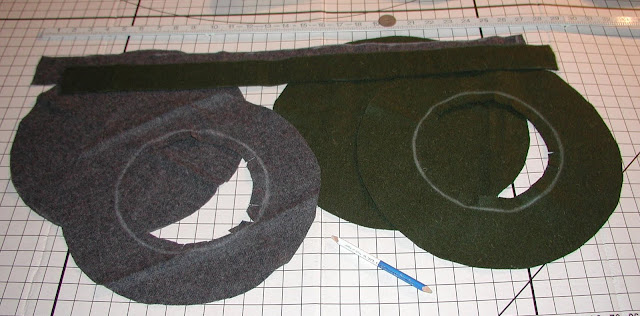

Since I have a rather large head I scaled up some instructions I found on the net and cut 2 13 inch circles of the green stuff rather than the 11 suggested and 2 12.5 inch circles of the grey lining wool and a 2 inch band of both long enough to go around my head + 2 inches.
I then measured the head hole of a hat that fits me correct and using a chalk pencil and a compass drew a circle in one each of the outside and liner pieces. I then cut out a circular section about a inch in from the line towards the centre of both marked pieces, then cut tabs about a inch wide up to the chalk lines.
At this point I remembered to iron the pieces!
I have pinned the sections together as below

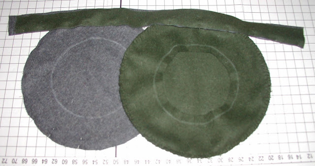

and so far have sewn the top and bottom of the outer part together about a third of a inch in from the edge and then went round again and did a line of whip stitches to make it a bit stronger and discourage the edge from fraying.
Tommorow I will do the same with the lining and make up the head band, I'm not quite sure how wide to make that or how best to fit a draw cord.
