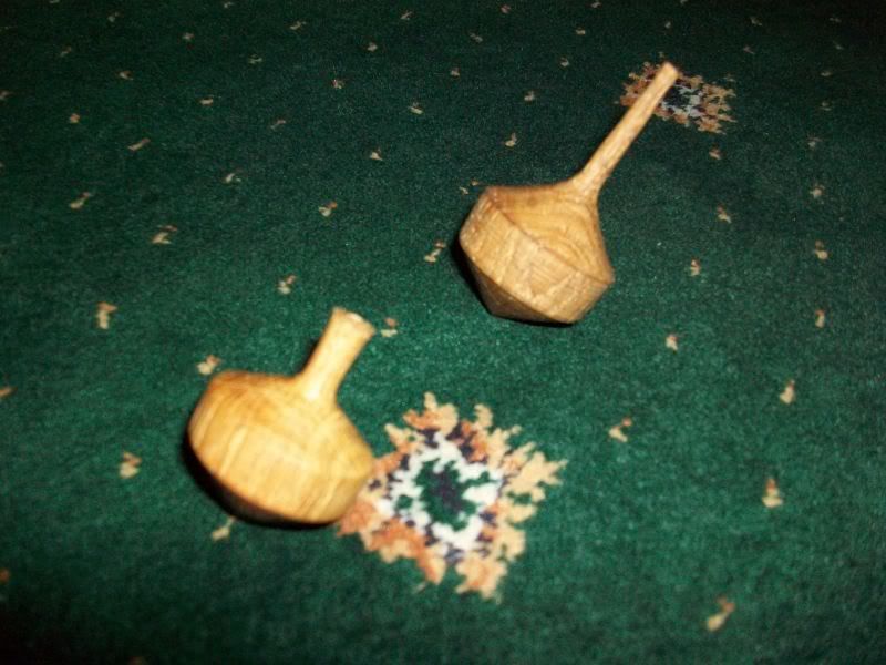

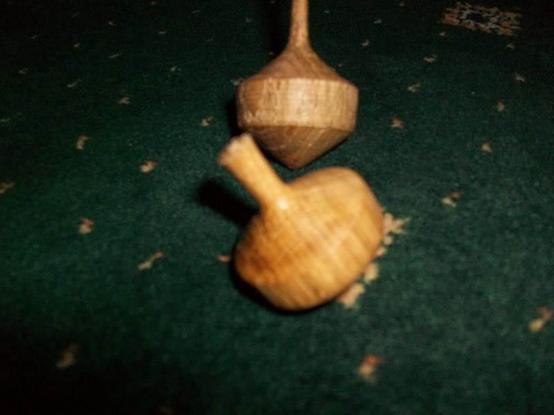

here's my little attempts today.

nice one hiho....might have to give them a go :)

the biggest one didn't get sanded as I snapped it off on the last little cut. came straight off and hit me square in the centre of my face visor :)
I'm in the garage with mine. got a nice lined oil streak all up the window, the visor and my T-shirt, as it was the first time I had used the chuck on it today
