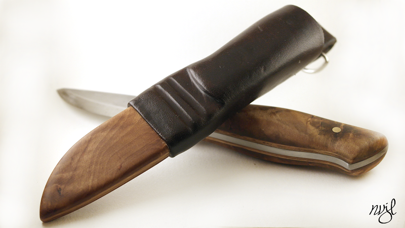

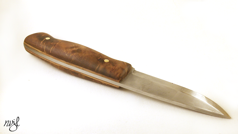

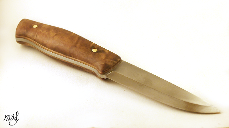

Thought I would share my latest handmade made knife to inspire you all to make you own.
You only need basic tools like saw, rasp, files, sandpaper, sandpaper and more sandpaper. :p Other than that you only need a few free week ends.
Note before the pictures:
Was a bit busy with "life" so I kind of forgot to take photos of this knife when it was finished. So this knife had a bit of use and works great, even thought I don’t really like full-tang knifes where I can feel the metal tang.
Blade is a EnZo Trapper 95 in 01 steel.
Handle is Elm root treated with beeswax so seal pores and stacked birch veneer liner with a a mix of linseed- and paraffin oil finish.
The sheath is also Elm root with stacked birch veneer middle and then 3mm leather with belt loop and a D ring attached for having it low hanging.
Enough ramble from me..
Enjoy the pictures..

Makes me really happy that you all like it. Thanks for the great responds.
As for the birch liner it was a total gamble, was planing something different but it didn't look right and I had some curly birch veneer laying beside me so grabbed it ad it seemed like it would work. :)
And the Enzo blades are great. Was very impressed with the quality when I first got it and if anything I was more impressed on how good it was to use when I tried it.
