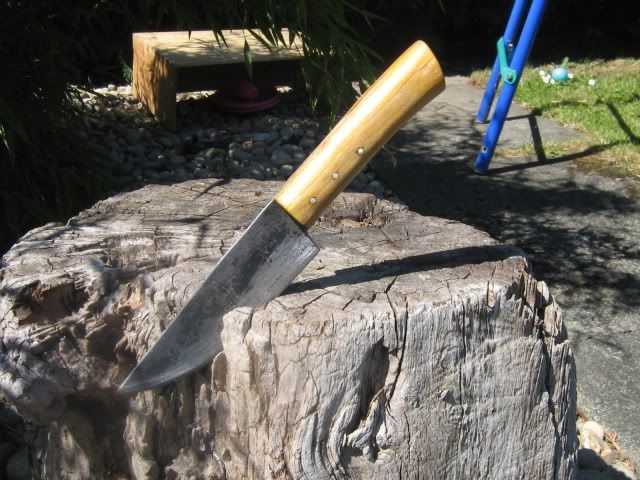

I just made a "knife" from an old chinese cleaver.
Yes, I know it's no beauty queen, but I was experimenting with a view to buying some 01 at a later date. I reckon the steel wasn't too hard but it must be at least in the Rockwell low fifties.
Here's a tip that you might find useful. Cover your steel in paper masking tape and draw your profile onto the tape. Mark where your handle pins will be. Drill the holes before you do anything else. To cut the blade I used a pound shop hacksaw and three silicone coated blades from B&Q, £3.50 (they don't snap every five minutes). Screw the steel to a big piece of wood like a railway sleeper or scaffolding plank using the handle pin holes instead of using a vice. You'll have to keep screwing and unscrewing it with the right bits sticking out to hacksaw out the profile. I also filed the bevels with the blade screwd to a big slab of wood. I think Claycomb is giving good advice. If I get some 01 I'll be trying a very simple profile first. On the otherhand you'll never know unless you try. Good luck!

Caliban, that actually looks pretty good from where I am sitting, Definately something to have sitting at the head of the table on christmas day, or at the BBQ.
