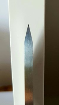

The knive came and after looking it over, there seemed to be a big difference in the grinds on either side with one being almost a millimetre bigger than the other. The retailer exchanged the knive and the replacement came today. It too seems to have a big difference in the two sides. I've closely messured the grinds at various points and there is definitely a 1mm difference. It's easily noticed if looking straight down over the knive point (as in the photo). I would have thought that the two sides of the point should be perfectly equal for an equal grind but as the photo shows, one side is noticeably longer than the other. I maybe wrong but wouldn't that mean that one side has a different grind angle than the other. My question is this... is this normal and am I being pedantic or has Castrom got a quality control problem?

There are knives that are asymmetric by purpose (like the Yakut) but I don't think that was supposed to be.

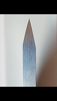

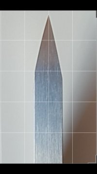

These two photos show the differences a bit better.

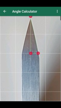

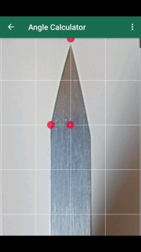

Thanks for that. That was really helpful. I can understand the problem a lot better now. As best as I can measure they are different. I've added a couple of photos with an angle app on top of the blade. The shorter side is 13 degrees and the longer side is 11 degrees. By taking the shorter side down to match the longer it would finish with a grind of 11 degrees on both sides. I suppose my next question would be... is 11 degrees on both sides ok for a scandi grind on a bushcraft knive?
