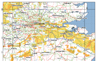

Your area is considered low risk, but if you are concerned you can buy a monitoring kit for £50 from public health England.
Have you bought your house in the last few years? The risk potential should possibly be in the survey.

If you ever sell your house then the second level survey gives your risk level for radon. If the actual tests cost more than a survey then perhaps a survey might be a cheaper way to find your risk level. Or just go to that interactive map because that's what the surveyor probably uses. The UK has been fully surveyed now. I think my testing was part of that nationwide survey.

We use Radon UK for reports to inform our foundation designs. The free to browse mapping data is very generalised and you should really get the full report before relying on it. I built my house with a radon barrier and depressurisation sumps for full protection but they updated the data a few years afterwards to show we're basically in a risk free area. I sleep with the window open all year round though so I don't think our house would ever have been at risk with us living here.
