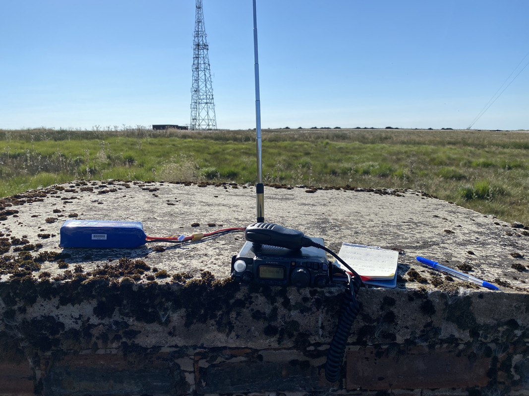

Haven't been on BCUK for some time and just noticed this. Took my foundation in summer and my intermediate in autumn. Will do full in spring. Would love to try SOTA but I live in the fens! I have experimented with a portable 25w UHF VHF rig running on old laptop battery cells. With the right antenna it's very good indeed.
