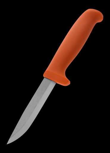

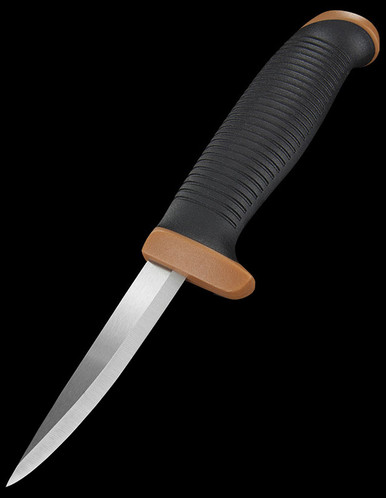

I would go with Hultafors for the straight knife. Its a tiny bit longer than the Mora, but it is cheaper and just as good. The guard arangement can be filed off, but I think it can benefit a beginner.
£7.95
I also like their double knife sheath, which has both a Craftsman, which is a good carver, and a Heavy, which one can use for baton splitting.
