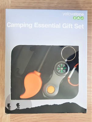

in the yellowstone brand [sold in what stores] there is a kit that comes with a fire-steel that i use
i bought mine last year when visiting Wales it cost around £5.00 gbp
it does come with a coating on the steel which needs to be removed [i guess a lot comes with a coating though]
after the coating is removed it never misses a beat and sparks every-time now i got the technique mastered
best to hold the long-side of the striker on the steel still and pull the steel with medium to firm pressure between the striker and steel
i think it was called a gift pack or something similar Yellowstone Camping Essential Gift Set
it comes with a
striker which has a bottle-opener built in
mini carabina
combination compass and button-cell torch which can be separated
steel is about 2" long
overall length about 4"
striker about 3" long
weight 34g including supplied cord
i found one on ebay exact same one as mine for your visual
