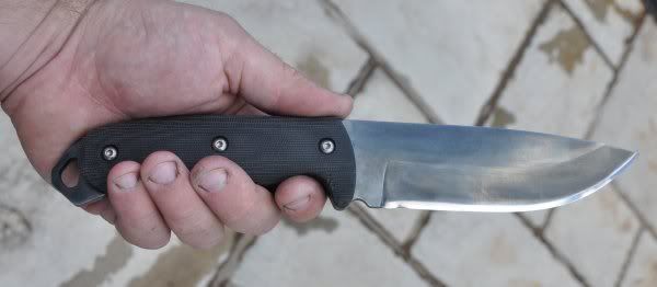

i have just done a couple of big tactical bushy knives (well finished them from last year )
thse are 3/16" (4.47mm) and wide blades so prety strong the scales are 3/8" Black Micarta nad green black G10 and are only bolted on so are removable but i had to make threaded bushes and drill acuratly and counter bore both sides of each scale etc tho i couldnt really glue thses scales as i would have removed the blacking on the spine (which also adds some rust protection)
theres lots of ways to make a knife
