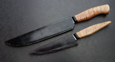

Finished these over the weekend for my dad’s Christmas gifts. Need to make sheathes to protect the blades in his kitchen cutlery drawer.
AEB-L is impressive in thin edges.

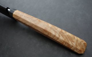

Black paper Micarta bolster and stabilised curly California redwood from the arboretum my mum has volunteered in for over 20 years.

Very impressive Chris.
Curly birch handles? Have you treated them at all?
They look like they'll take a fine edge. Nice dimensions too.
My bad, original post now list handle material.
Stabilised curly redwood. Just sanded to 1200 and hand polished.

Extra pictures added to opening post.

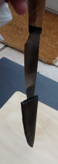

I made my leather sheaths and finished them last night. Both are made of 1/16th leather with thin welts so they have friction with the blades. I also fitted a couple of 4mm diameter flat magnets in the mouth of both sheaths. They will support the weight of the small one, but just offer some extra resistance to the large one sliding off.
For a gift these are good, but I might be looking for some 0.5mm plastic for my own kitchen drawer!
