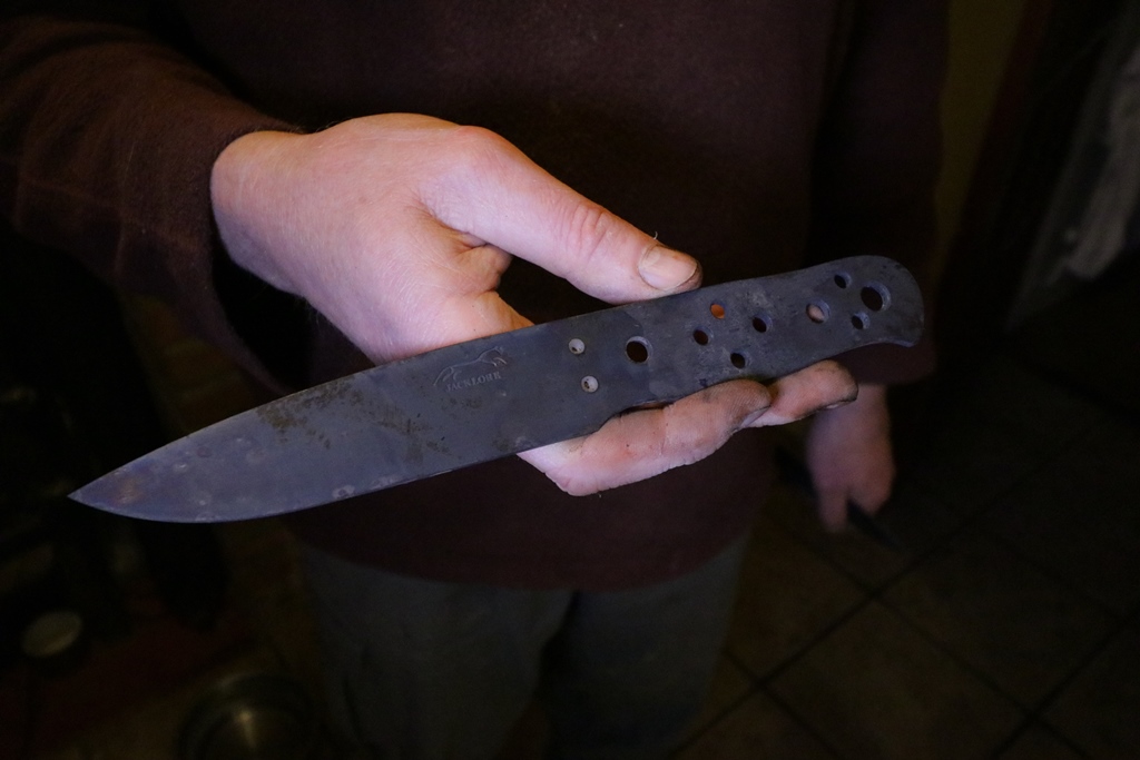

Once the handles had been drilled (for the pins and assist bonding for the scales) the blade was coated with an anti scale compound to stop loss of carbon to oxygen when the knife was in the kiln for the hardening process.
The knife blade was placed in a knife makers kiln for heat treating and quenching. The blade was check for any warps but all was straight and true.

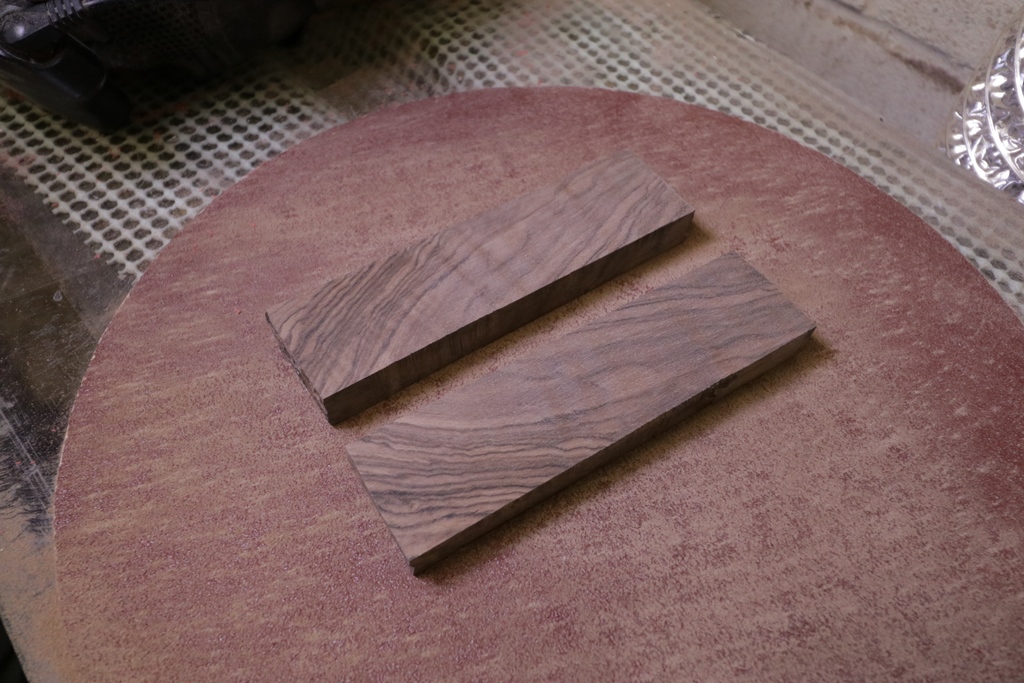

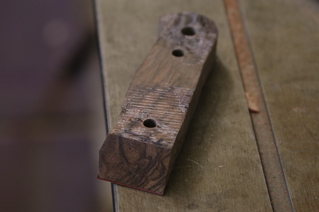

Liking a dark wood for a knife handle I choose some walnut for the scales of the knife which had previously been stabilised by Sandy. These were prepared and keyed up for bonding with the blade.

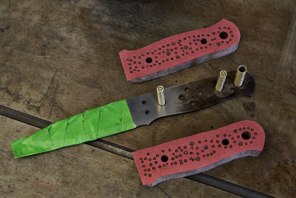

The scales were keyed up ready to attached to the blade and clamped in place to cure 24 hours.
