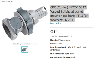

Does anyone recognise this type of fitting and can suggest a ( far ) cheaper alternative ?
So Its a main feature is that it can be 'closed' by pressing the button on the side of the unit to seal it if the Male part isn't present and in situa. Looking for a cheap alternative - may have to think of using a twist valve if needed.

I’m guessing a standard hozelok fitting won’t suit?
I may have to go that way but the Hozelock doesn't close into an 'off' position once at rest. Unless anything has changed?
The advantage of that pricey fitting is that the jerry can is sealed again once the male insert is removed.

Yes it does.
Just pull back the sleeve, pull out the male and the hosepipe it’s closed.
Shove it back in and it’s open. When I have the jet attached then there are Two closures - I can twist the jet closed or I can click it out and rely on the connector.

There are plenty of 'Stop' Hoselock fittings but not a bulkhead one that I have seen - so, you could use a standard bulkhead connector with a short length of hose terminated with a 'Stop' connector.
That may work - I know Hozelock are the de-facto market leaders but I've never been super impressed with their quality control.
I think my next port of call maybe the yachty brigade.
I have some that have a plunger inside that shuts it off when whatever attachment is removed. I’ll do some digging.

I’d definitely go with a standard blue shutoff valve. All that expensive plastic fitting is adding is a press button rather than a twist valve, you’ve still got to operate it by hand so why overthink it?
It’s also more vulnerable on something that’s going to be bumped about. The blue valve can be properly locked in place with washers and nuts.
