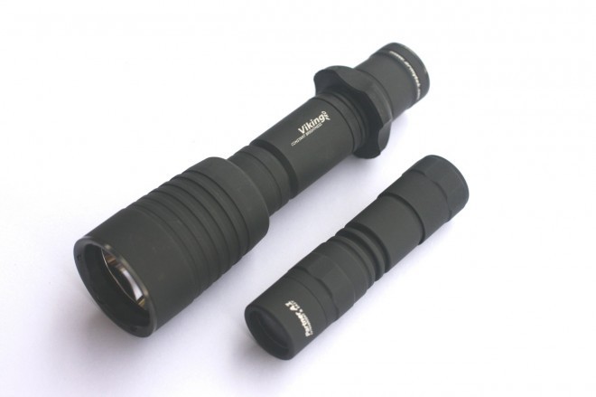

Nice one Chainsaw, I like the Armytek stuff, that little torch seems pretty good. Build wise, they’re tanks. I really really nearly bought the original Armytek Partner C1, seen here.
http://budgetlightforum.com/node/22952
Coolest rough, gritty anodising, great tactical look, pocket friendly etc. But it got bombed for its user interface, not at all user friendly. I’ve been tempted by a few since then. It’s a shame to see that clip damage on the ano there. That’s not the ano they were using on the Partner. I reckon this ano would scratch up and look good for it.
