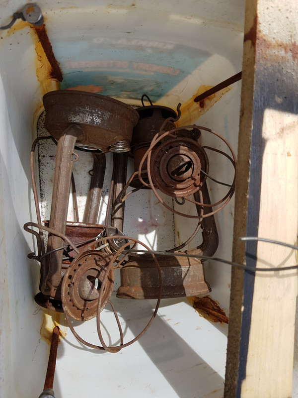

I'm working my way through my lamps that need cleaning up and the next ones to get the zap bath treatment were a couple Feuerhand 275 Baby lanterns that were made when there were two Germanys...
The obligatory before picture

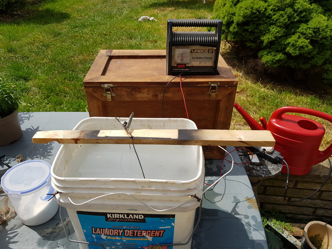

My electrolysis setup. The charger is about 30 years old but performs admirably in its new role
Something's happening...
After 4 hours

This is the video I used for my setup if you need more info
