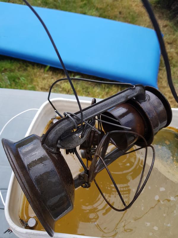

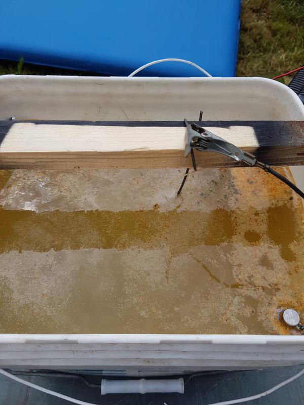

I decided it needed a bit of freshening up so in the bath it went

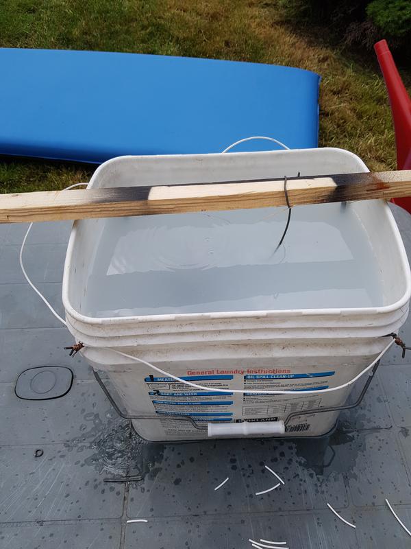

In went the water with 'bath salts'

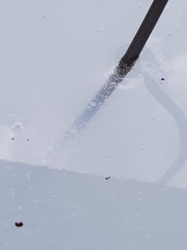

Then on went the electricity for some bubble action
It was really grubby

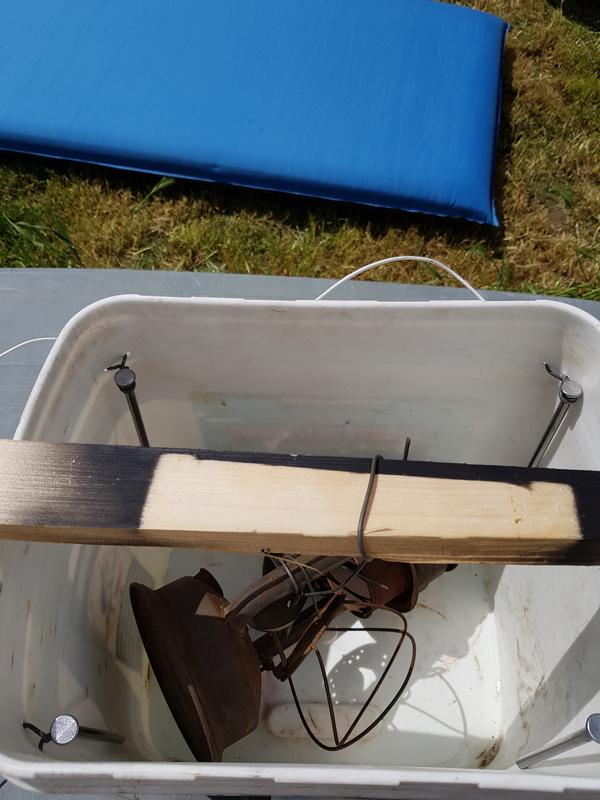

I had a look after an hour and thought, nope it needs more time in the bath getting zapped
After 2 hours I had another look... not too bad but it went back in for another couple hours

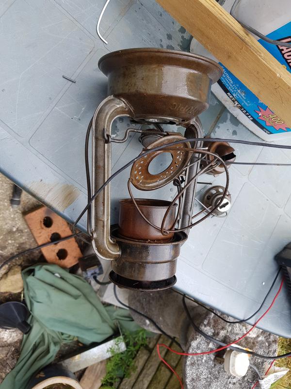

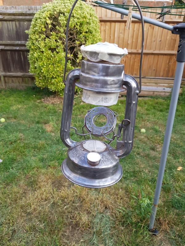

After drying I rubbed it down in readiness for the primer. It looked pretty good then but I knew I could do better.

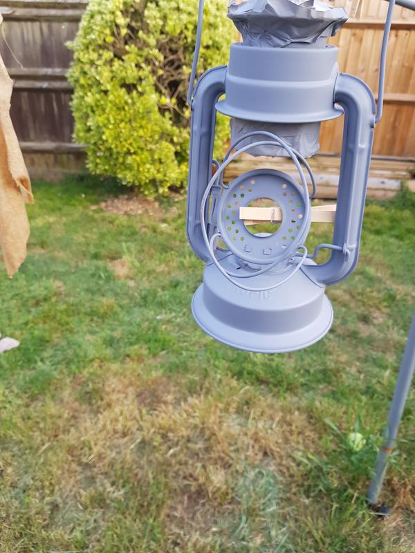

First of two coats of primer

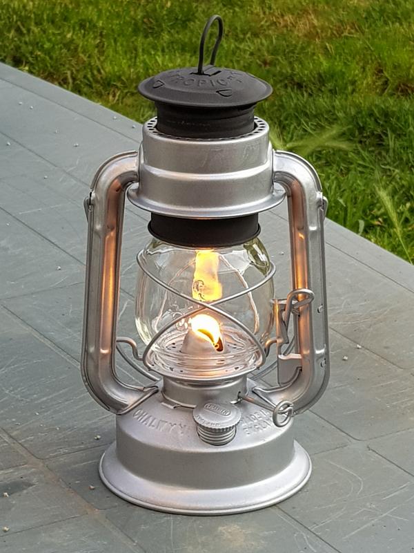

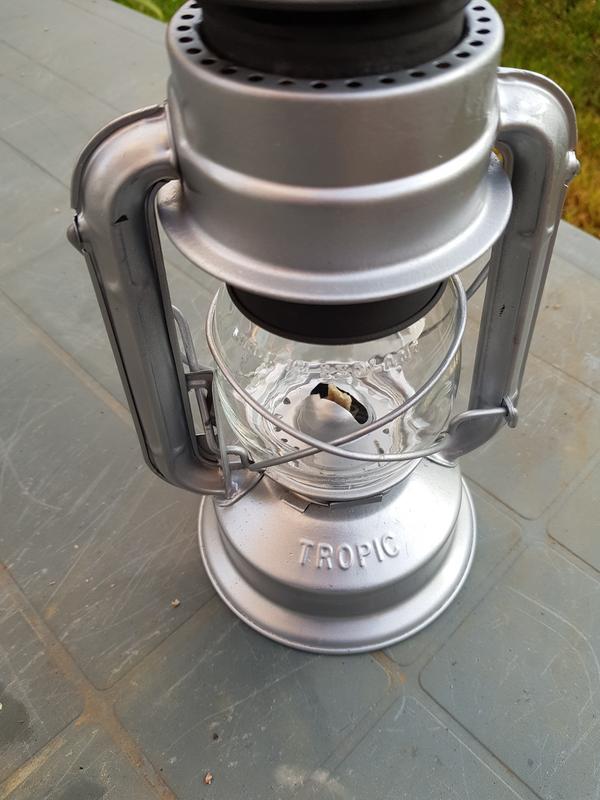

Then it was finished with two coats of silver plus a high temperature paint on the chimney as I wasn't sure how the silver would hold up on it. I think the two tone finish looks good :)
Of course I had to finish with the lantern lit :D

When doing the rust etching of parts that have an internal surface, I try to add an electrode up inside the item as well. That can help clean the insides up a little better.
