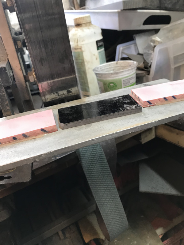

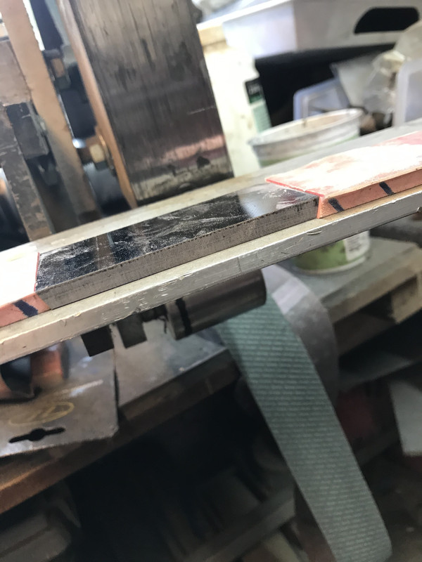

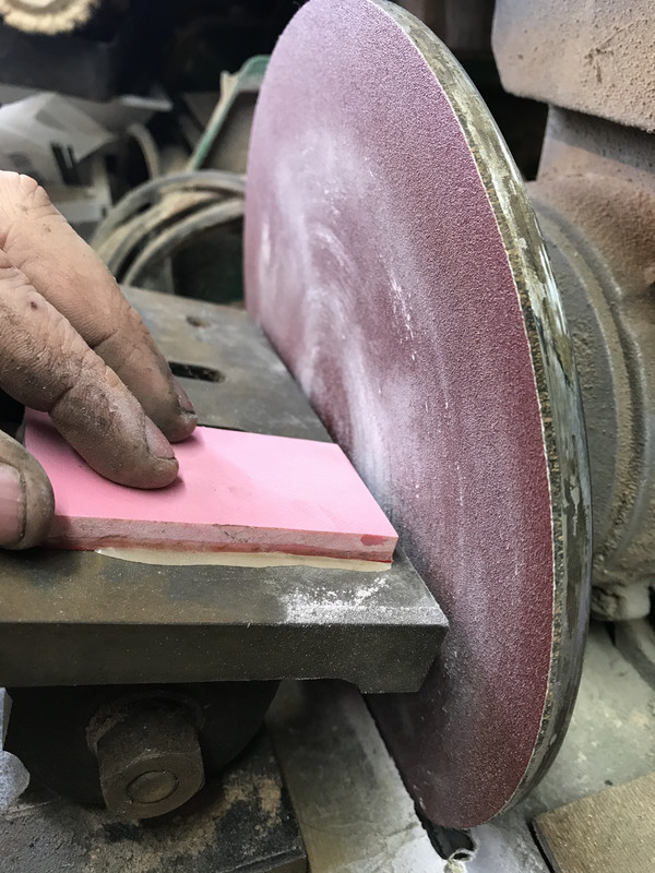

I’ve finally solved getting a clean angled bolster joint ( I hope!)
Wanting to join these nicely with an angle:

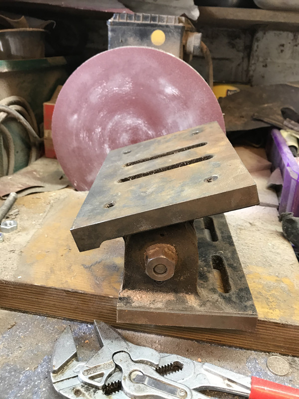

So I acquired this adjustable machinist ‘thing’ a while back. Not sure of the proper name but rotates so smoothly and reassuringly heavy.
With that one item, it becomes so easy to match angles.
Set it this way round for one end:
and then the opposite way for the other:
Perfect!
No matter what the angle of the table, each end will match as long as it doesn’t move between.
