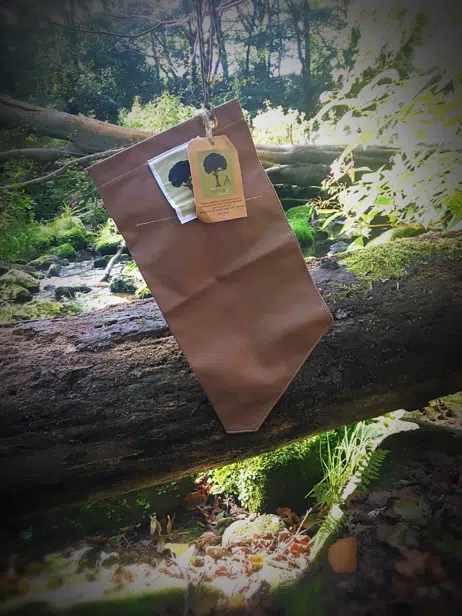

 Small bag, 3 litres.
Small Brown Filter bag

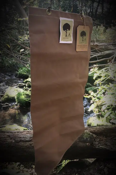

 Large bag, 20 litres.
Large Brown Filter bag
The small bag will filter about 3 litres of water, and the large about 20 litres so lots of water can be prepared quickly.

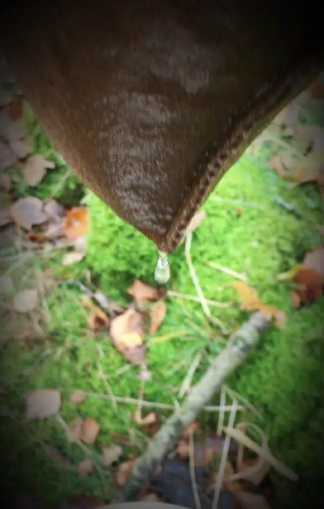

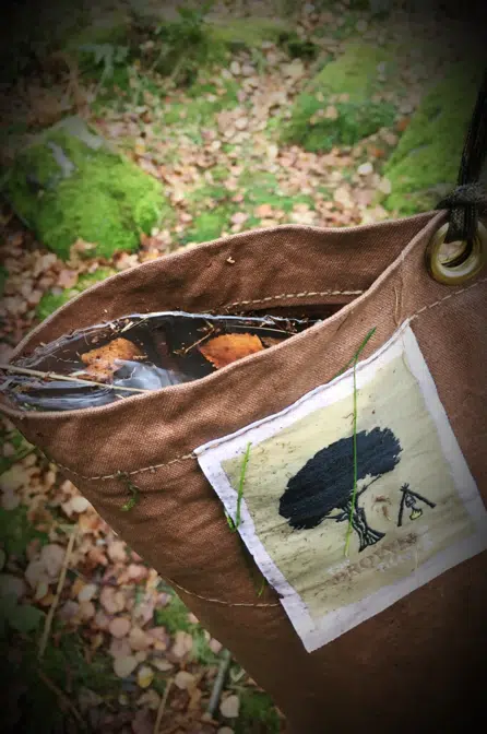

The instructions on are simple, soak the bag in water and rub it together to open up the fibres, then fill the bag with dirty water to the top. Once the bag is hung, allow water to filter through until it lowers to the sewn line, oddly this fill line is only on the smaller of the two bags tested so I started catching the water after about a quarter of it had drained out onto the floor. It’s really that simple.
Having tested it with some pretty dirty water, it filter out all the muck to an exceptional standard, yes I’m sure that in a microscope you would still see bits of mud or other items coming through, however as you can see, to the naked eye it’s done a good job which will allow the secondary purifying methods to work well.
The test I conducted was done in a semi-controlled manner, by that I mean I got a billy can, full of tap water and threw in a few handfuls of mud, leaves and whatever else was dragged up with my foot. It was all mixed into a nice muddy soup and the bag sunk into the soup. I left it there for a few minutes whilst I found a clean billy to catch the clean water, then returned to my brown bag soup mix, pulled out the bag, gave it a good squeeze and hung it from a tree. It was slow going and I had expected the water to flow quicker, however, as it was very dirty water the slow filter rate through the canvas is understandable.
Brown Filter bag full of dirty water

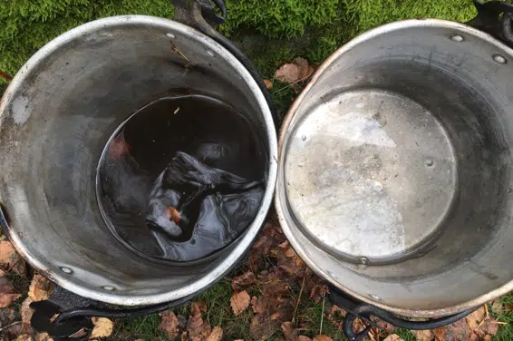

Check this for a before and after shot, I’m quite shocked at how much it actually removed, now the water did have a slight colour in the photo, however these billy cans are very old, so have been stained over the years.
Before and after filtering

Clean water from the Brown Bag
For me to filter a cup of water it took about an hour, it was very dirty water and I’m sure the more the bag of roughed up, this will speed up.
