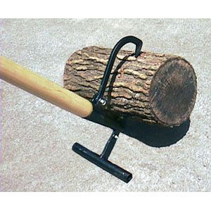

Tool on the left is a Peavy hook and timber jack. Its used for rolling tree trunks if you remove the bit on the top right of the tool.
The tool next to it is used to Spike and lift or drag logs rather than bending over to pick them up and wrecking your back
It has many names iñcluding a timber pick, sappie or hookaroon
They are basically tools to help me move biggish tree trunks now I am old :eek:
